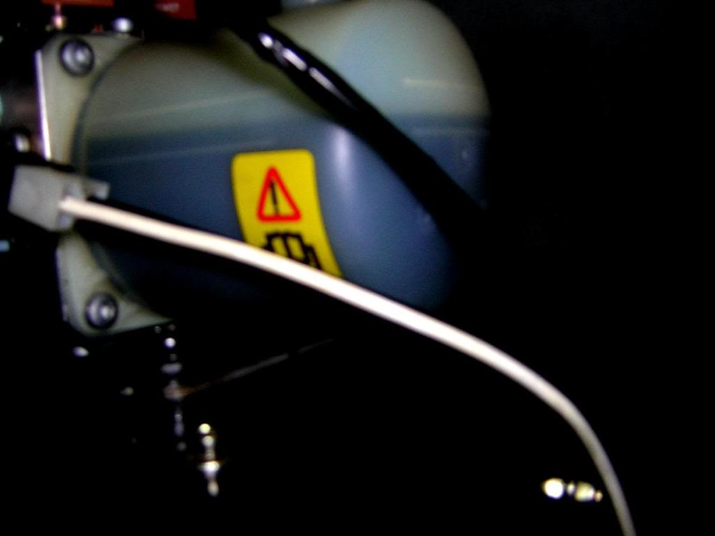

Thanks for the quick response! I've been snooping around the pump etc already (which is how I found that the Allen key was missing) but still cannot figure out this reservoir thing. Hard to see up there but easy to photograph
Those are the reservoirs right? (There are two?) They are opaque near as I can tell.
What am I missing and thanks again!

No, the reservoir is part of the pump body, you can see the fluid level through the opaque plastic. It should be between the lines.
The relief valve kit has been discontinued, steveinfrance did his own version, so you may want to search his posts.

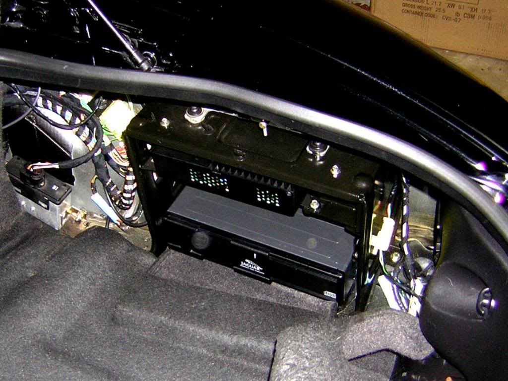

Oh wow thanks, that explains it. Now why is mine so much higher under the fender than yours is? Is my audio-equipment bracket higher for the amplifier etc?

That's not mine, it's a pic from Gus's site, the nav unit and cd changer sit on top of each other if there is no nav the pump will be lower.
Here is Steve's thread https://www.jaguarforums.com/forum/x...mp-plug-70317/

Thanks Norri... actually mine has a blank space for the nav unit but there is an additional amplifier on top which I believe is for the optional audio upgrade. So it's all a bit higher if I'm not wrong.
Anyway sure enough I'd been looking at the reservoir all along without realizing it. Level seems perfect (you can also see that my garage floor is sloped Name:  icon_smile_tongue.gif

Edit: Here's what I mean about the amp...it's located two bays above the CD player:
