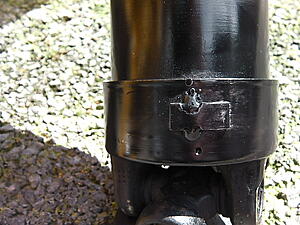

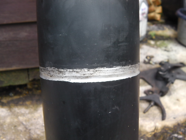

Default prop
The prop i off at last, and has been dropped off for testing to see if it's still balanced as it has quite a deep groove to the rear of it which lines up with a bolt in the handbrake mechanism support plate.
There is also a small mark on the front which seems to line up with a small plate in the transmission tunnel.
Also the jurid coupling has a split around two of the metal mounting spacers so a new one has been ordered.

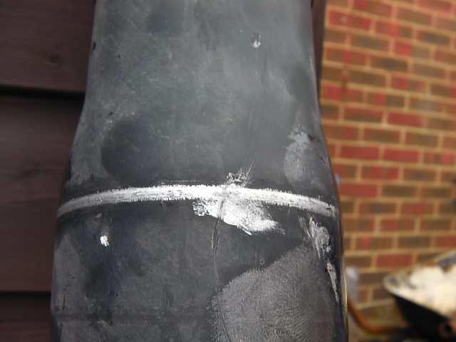

Default prop is back
I have just picked up the prop from Wimborne motors who have rebalanced it for me, Now i'm just waiting for the new jurid coupling to arrive the it's refit time!!!!
