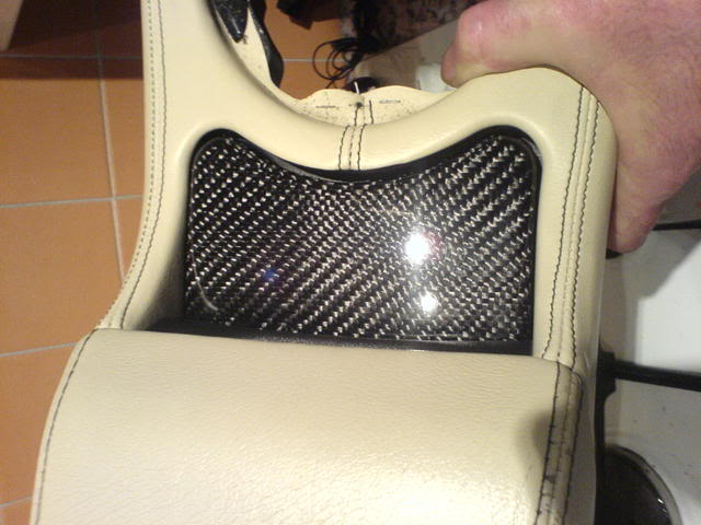

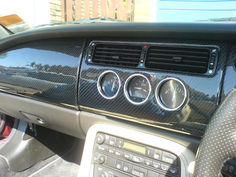

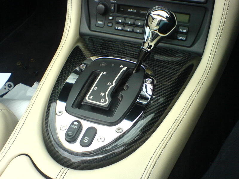

I've recently been modifying my xk8 with a full carbon interior, all made by myself in my garage lol..
heres some pictures of the bits I've done so far, your thoughts would be very welcome..

the latest addition is the ashtray top, which has just gone in...

Looks nice Tony. How are you doing this? I've never heard of anyone doing it themselves at home...am I missing something?

yes Spurlee,I do quite a few bits at home, for different cars, just cover the original items in carbon fibre fabric (in this case 2x2 twill weave), several coats of a top quality resin baked in a home made hotbox, flatted down between coats then (hopefully) the final coat is flawless, if not a quick flat down and repolish does the trick...
to be fair the above bits (except the ashtray cover) were some of my first attempts, and as such arent as good as i can produce now...
its taken me a year to just about perfect it, and the car is now pretty much a one off...

Did you move the power button for the top or do they all come

cheers steve, yes i moved the 'hood' button to beside the 'sport' button as I wanted a cleaner looking gear surround and didnt like the coin holder, so decided to bin it at the stage before the carbon went on...
was going to change the buttons for stainless ones but decided against it as the wiring was a bit beyond my skills to sort out lol..
