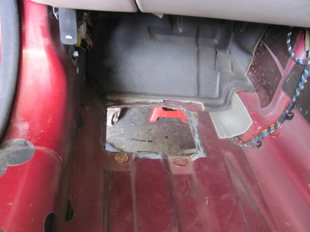

I am 5 miles north of Norwich about 2 hrs away from you, I can do your welding if you want, just like below.....

But seriously folks, does the floor weld dispense with the need for the existing cover plate underneath?
And is the black stuff paint or underseal?

The strengthener plate underneath was only there for production purposes, this is what the sheels were bolted to as the car went around the assembly line.... so no need...

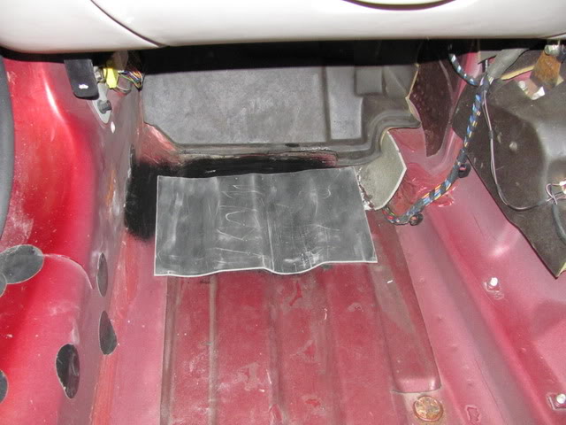

The black stuff is paint, underneath I use Gravitex, depending how bad a soaking your carpets have got you may need to hang them for a few days, you will be amazed how much water they hold...
Once the paint has gone off I stick on a rubber mat for sound deadening

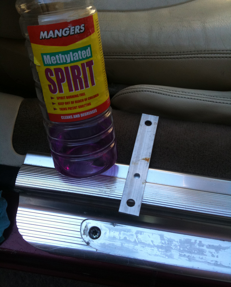

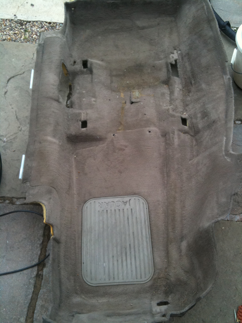

I thought I’d put up some pictures related to removing the carpet prior to welding in the foot-well area.
I removed the cover plates using a hairdryer to warm up the glue and then prised up one end of the cover plate with a fine bladed screwdriver, slipped a piece of 1mm copper wire under the plate and using a sawing motion, heated the plate and drew the wire along to un-stick the plate. Maybe adding rings (like on key rings) to the end of the wire would make it easier and stop the wire cutting into your hands?
The plate got slightly curved during the lifting process, but was easy to straighten by hand. I cleaned off most of the old glue and grime from the mating surfaces with an aluminium scraper and methylated sprits. To replace I used double sided carpet tape. Just ensure that when replacing the strip that the plate is offered up centrally and butted against the ‘well’ edge, then laying down into the ‘well’ smooth from the centre outwards, which will ensure no rippling and the plate will bed down flat.
I used carpet shampoo with a vax to clean up the carpet, and the results are great.
