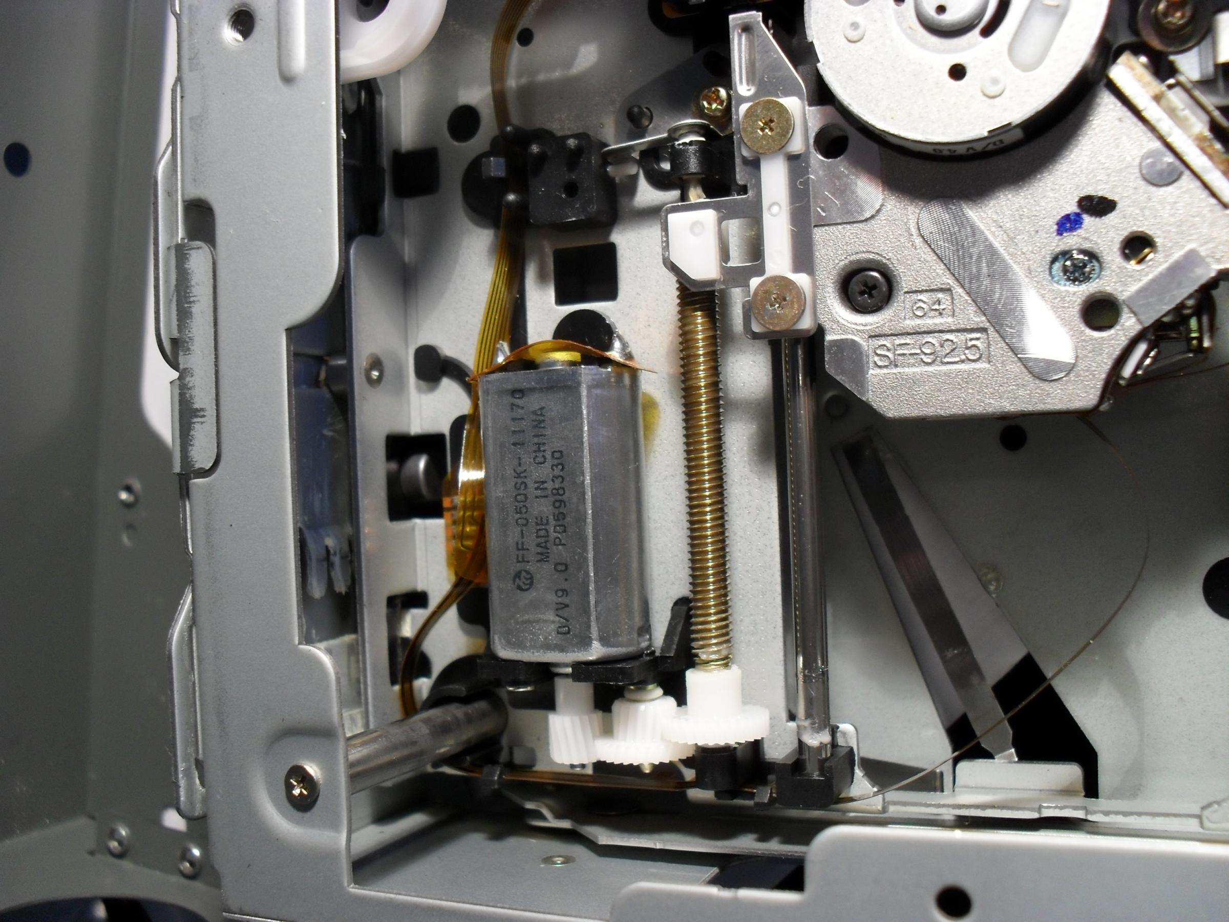

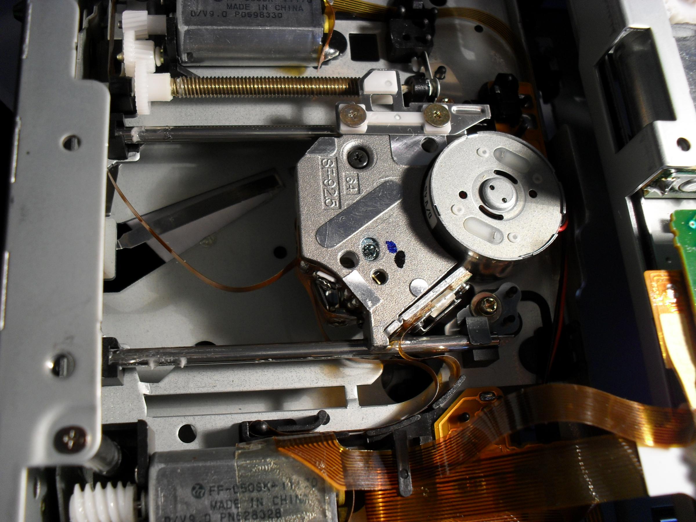

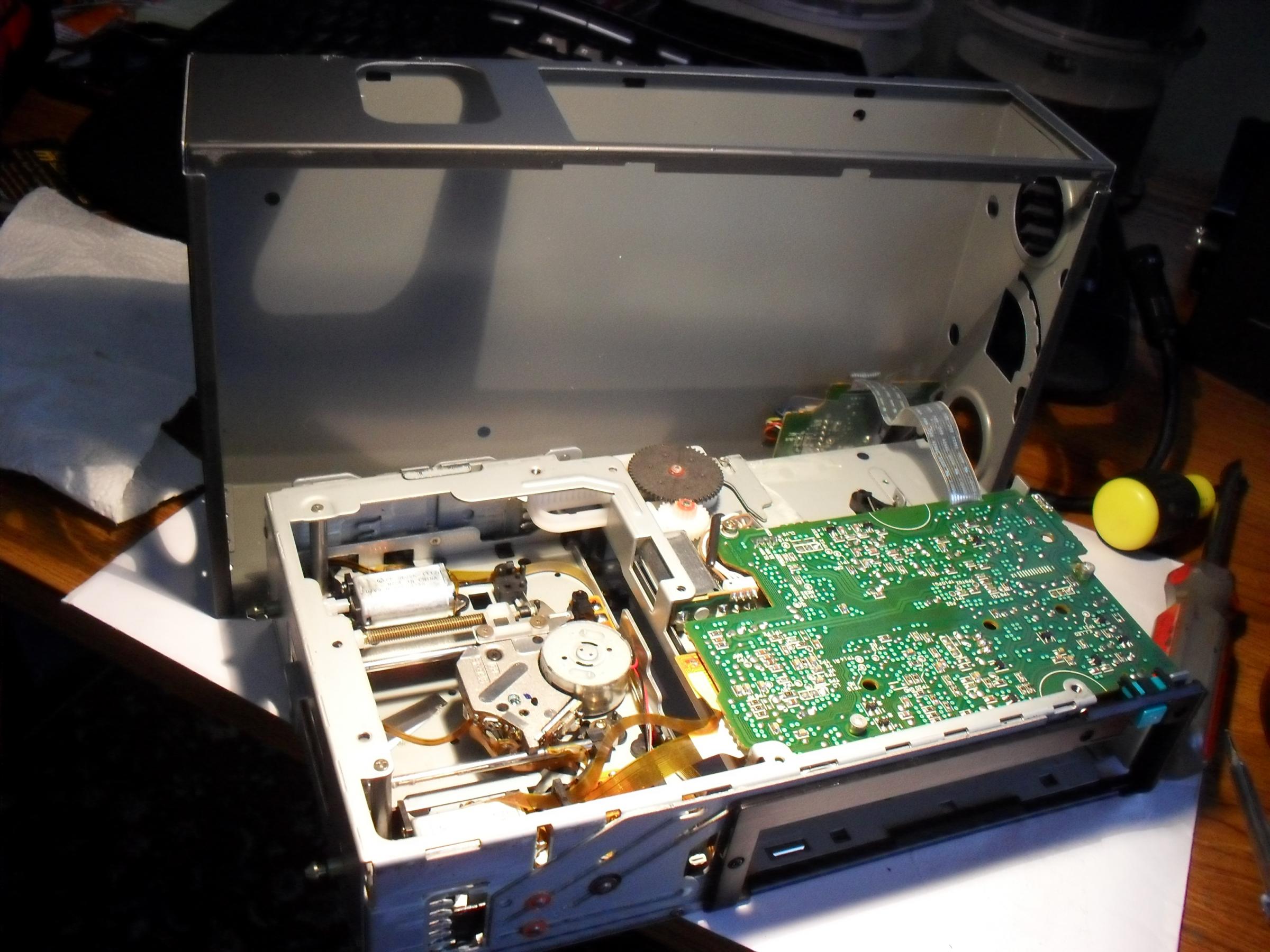

There was a thread on the forum a couple of years ago, it dealt with taking the player apart, cleaning it and then oiling the spindle and worm gear. I did it and it cured my problem, sorry dont have the link, someone else may be able to oblige. These are my pics from the refurb, I also cleaned the lens with correct cleaning fluid. Hope this helps.
Attached Thumbnails CD skipping-sdc10375.jpg   CD skipping-sdc10376.jpg   CD skipping-sdc10377.jpg   CD skipping-sdc10378.jpg
