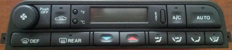

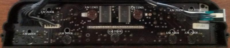

Had to fix a broken bulb and made some pictures giving an idea where which bulb is located.
Attached Thumbnails Center console bulbs-upper-front.jpg   Center console bulbs-upper-back.jpg   Center console bulbs-middle-front.jpg   Center console bulbs-middle-back.jpg
