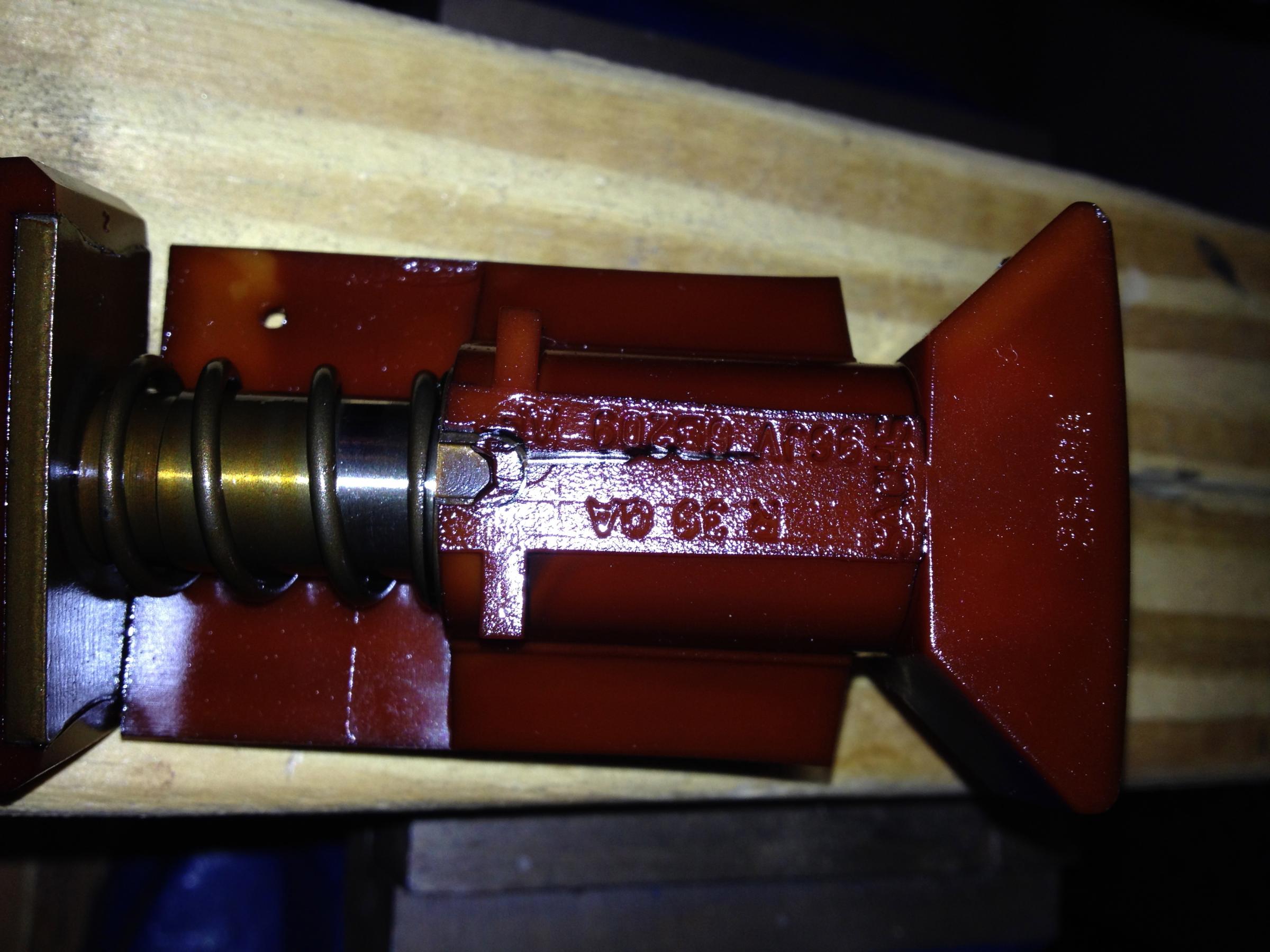

Glad for you. I changed mine last week and found one with a one inch crack!
And for you. Those look a different pattern and colour to mine.

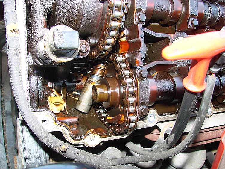

This could have been the next thing you would have seen:
Attached Thumbnails Chain tenioners - am I glad I took it in!!-jagtimechain12_zpsbd90262b.jpg
