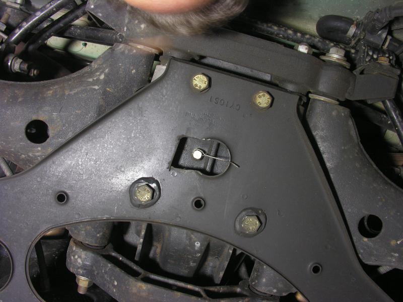

Here is what I did for a drain plug. As there is a seam along the middle of the access hole, it was necessary to enlarge the hole. 3/8" pipe is the thread and brass plugs are readily available. I used a square head plug and drilled it and used tie wire to secure it. As the bearings are regular Timken bearings, a quality diff fluid is all that is needed. Lifetime fluid not needed nor is the limited slip additive. If you drill the hole while the fluid is in it, the rush of fluid will guarantee any drilling chips will come back out.
