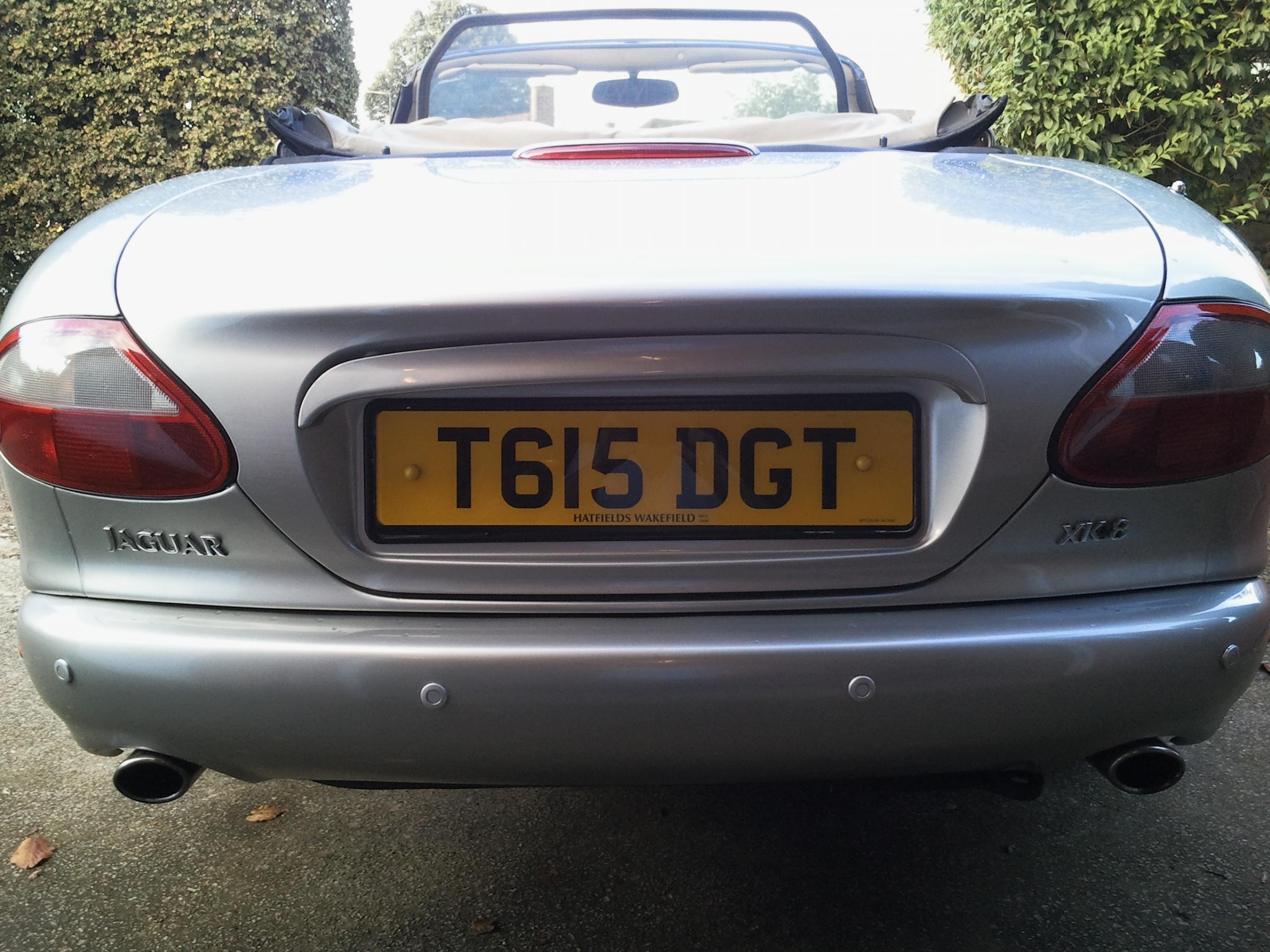

I know this has been covered before but here are some photos around updating from my 1999 body coloured plinth (broken) to a later chrome plinth. (supplied by Philhef).
First my car with the broken plinth

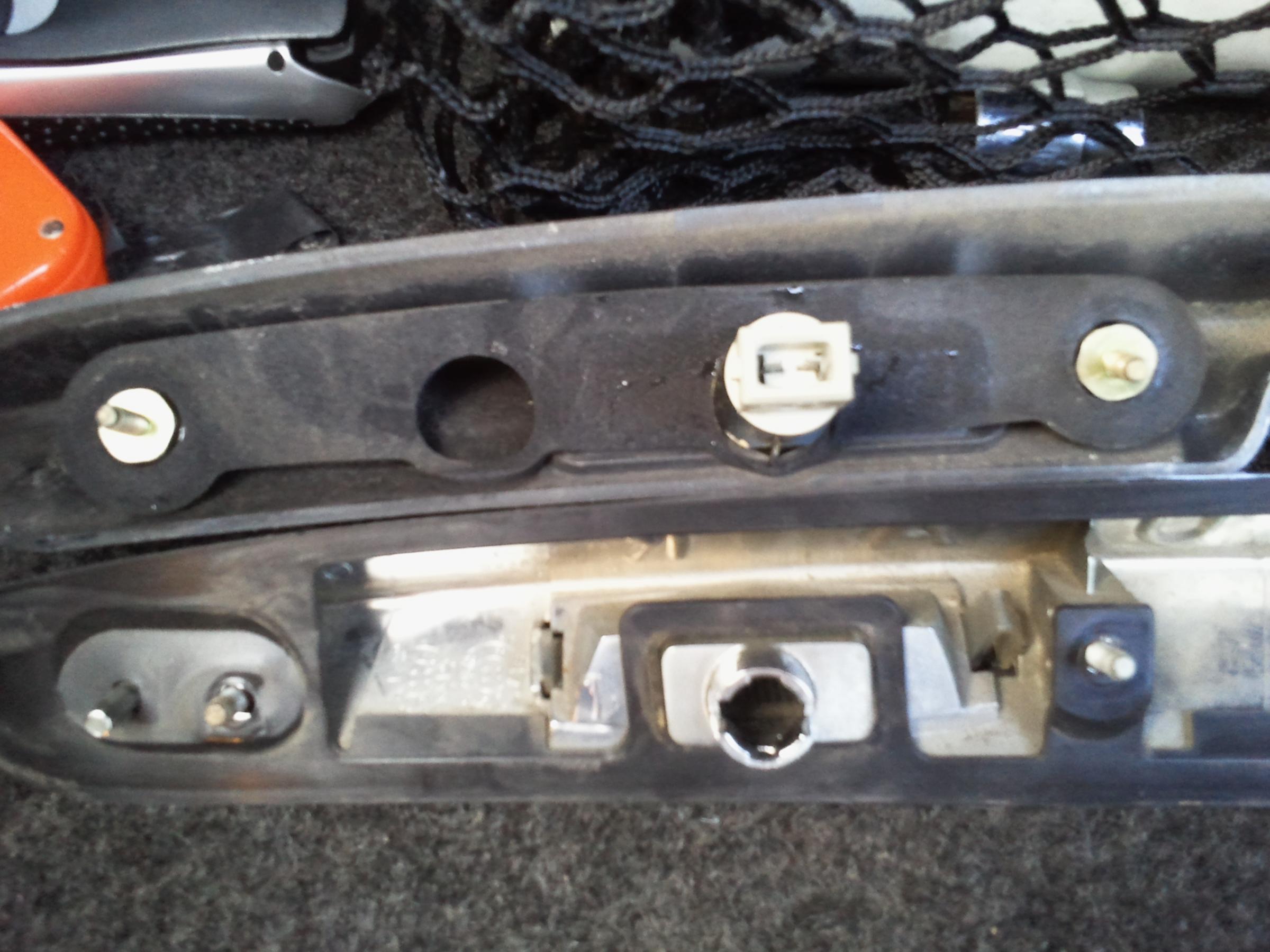

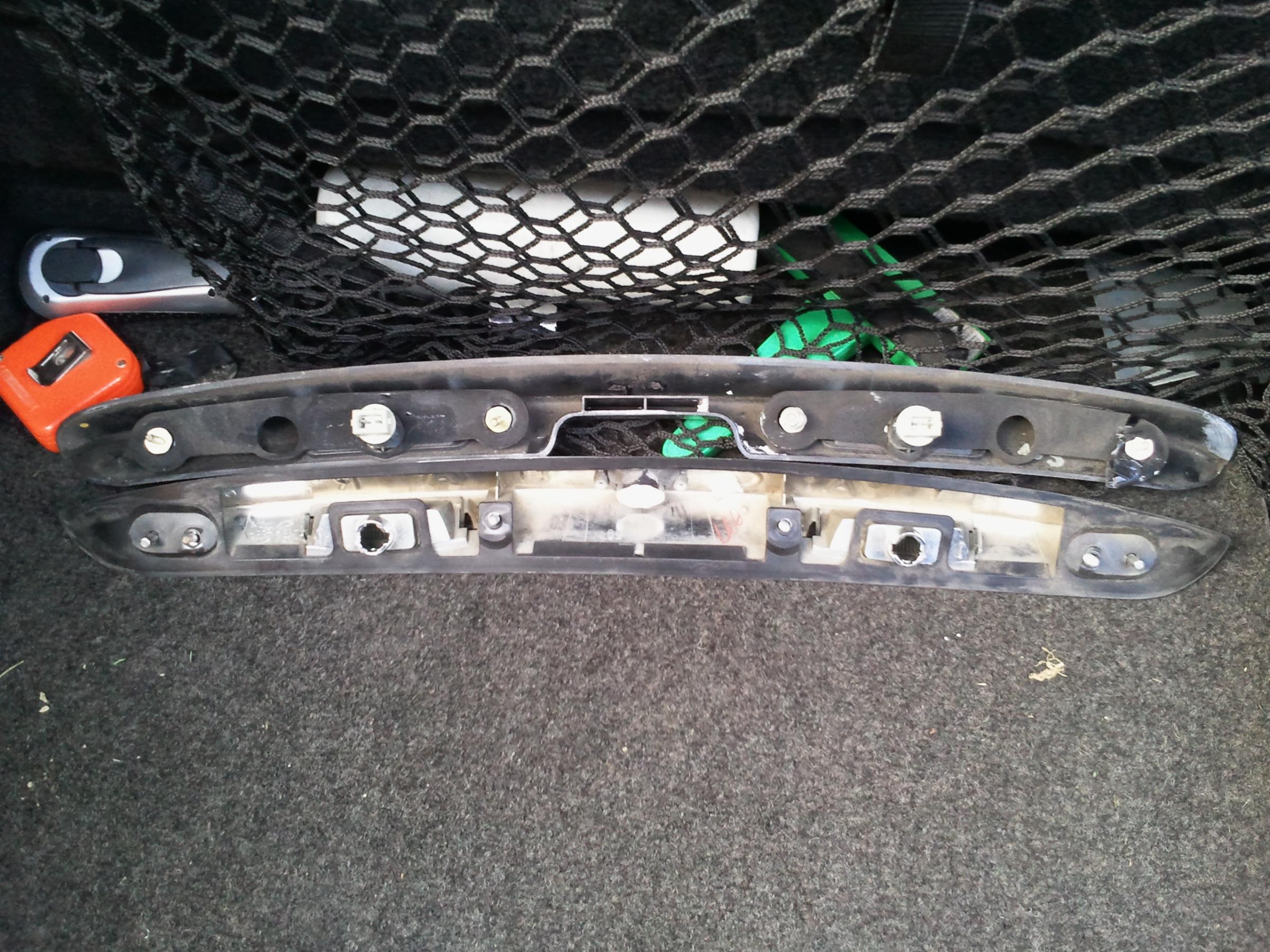

From the photos below of the new (bottom) chrome & old (Top) plinths togeather you can see that the old plinth only has 4 bolts, the chrome plinth has 4 bolts plus 2 locating lugs, so 2 x 6mm holes needed drilling inboard of the existing outer holes.
Also, on the chrome plinth, the holes for the lamps are larger and square, requiring them to be opened out.
This is further illustrated by the following, this shows the holes for the old plinth

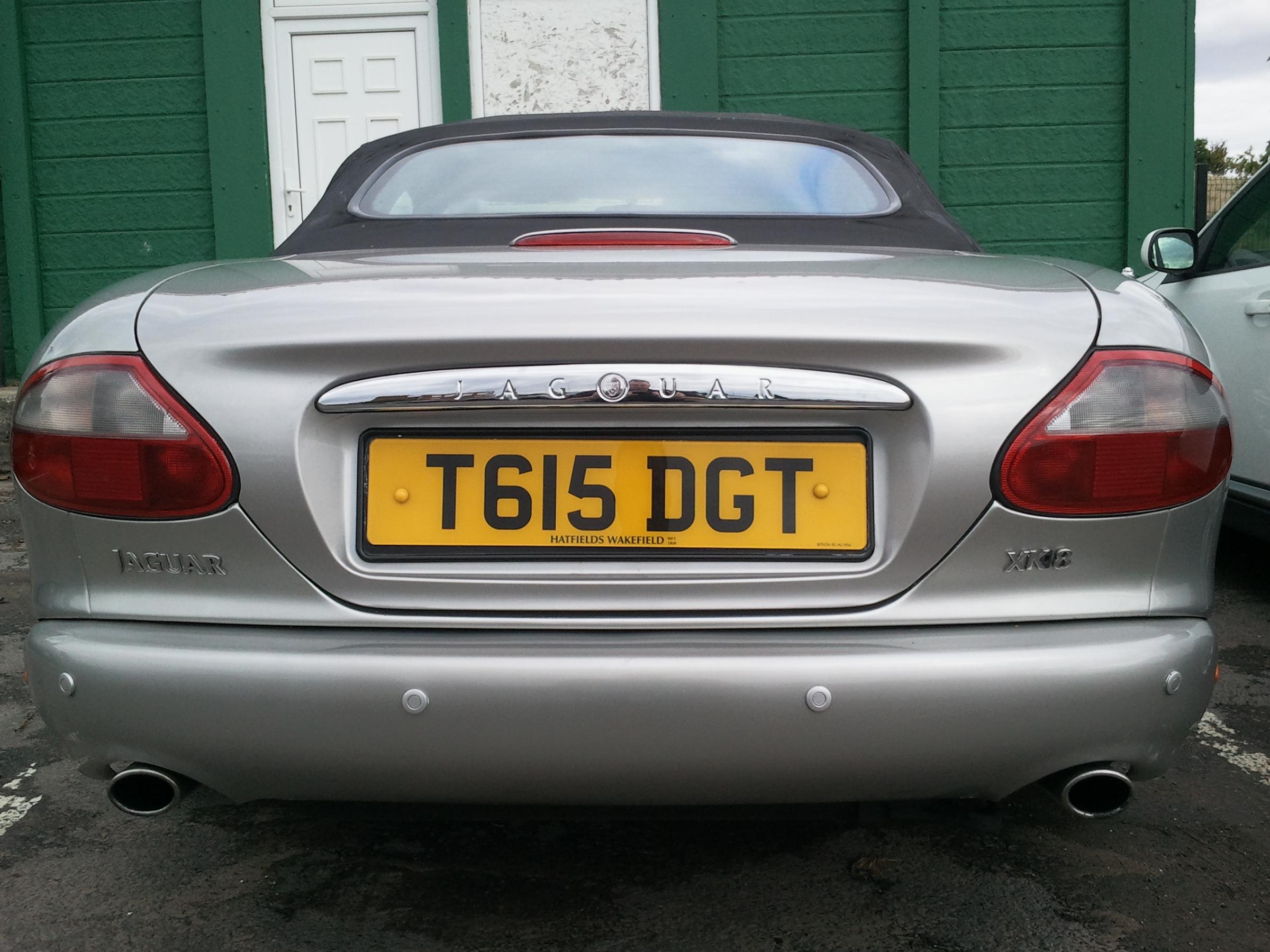

and this is the final result
I like it, but it makes me want to add chrome on the lights and around the licence plate, to tie it in better
Buy the way this plinth has a silver growler instead of a boot (trunk) release button (installed by philhef). If you do add a trunk release you need to drill another hole for the wires.
