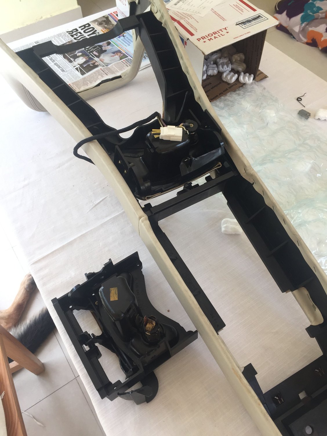

Default Pic of the ashtray/cigar lighter unit
Here’s a pic of what you’re dealing with once you have the Centre console out.
note the cigar lighter is moulded into the ashtray and the unit is also fitted with a light bulb.
