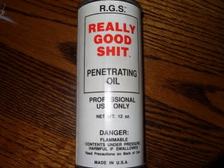

Default R.g.s.
I use R.G.S. when cleaning my shaft (antenna)!
on all of the others. It's "Really Good"!!!
