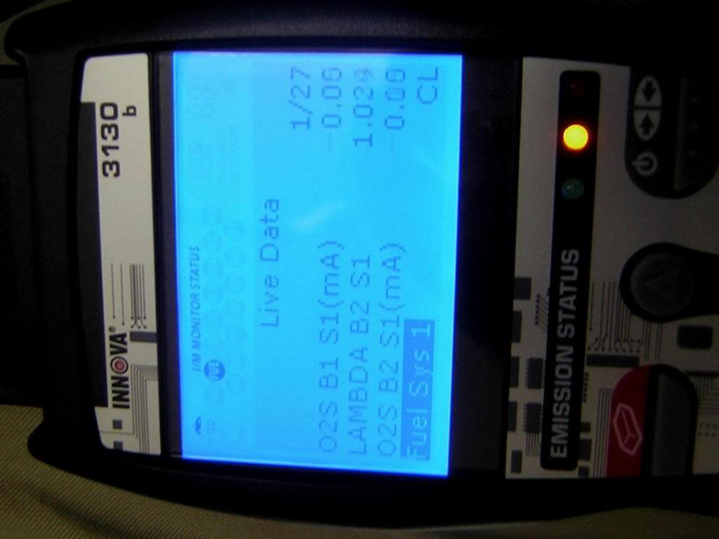

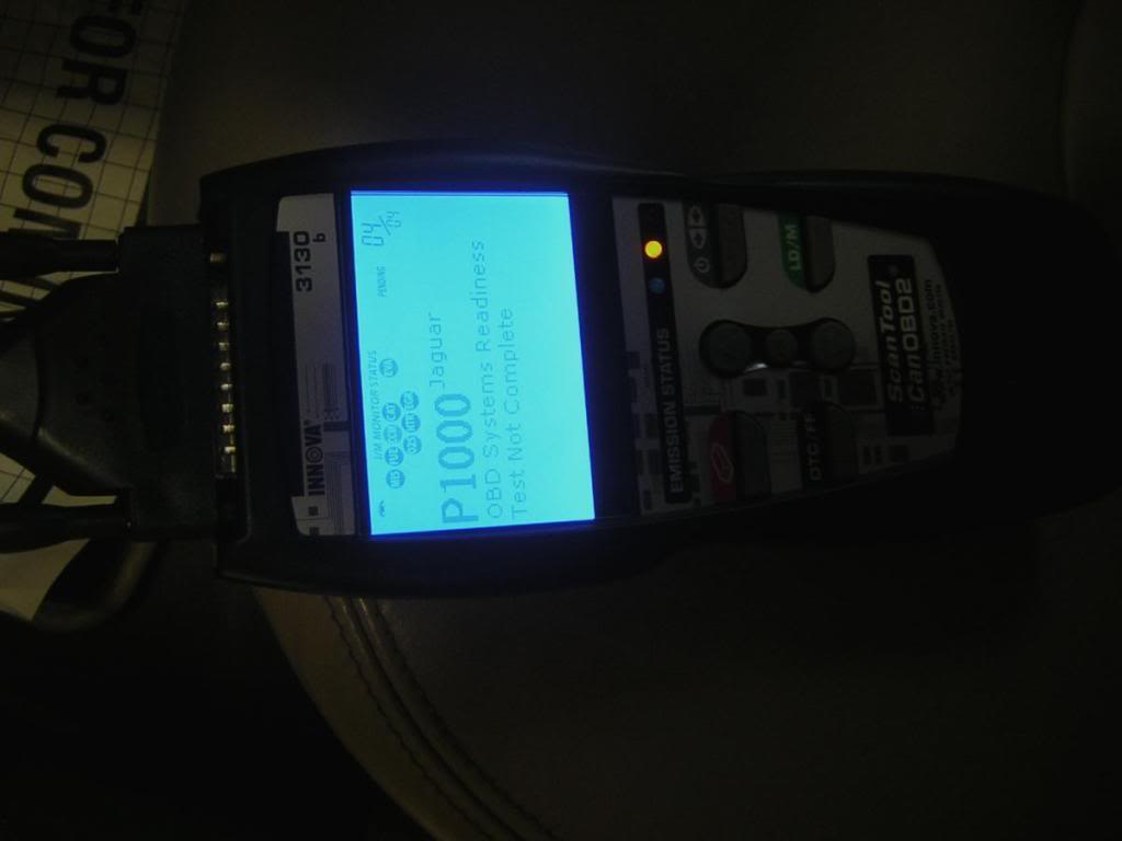

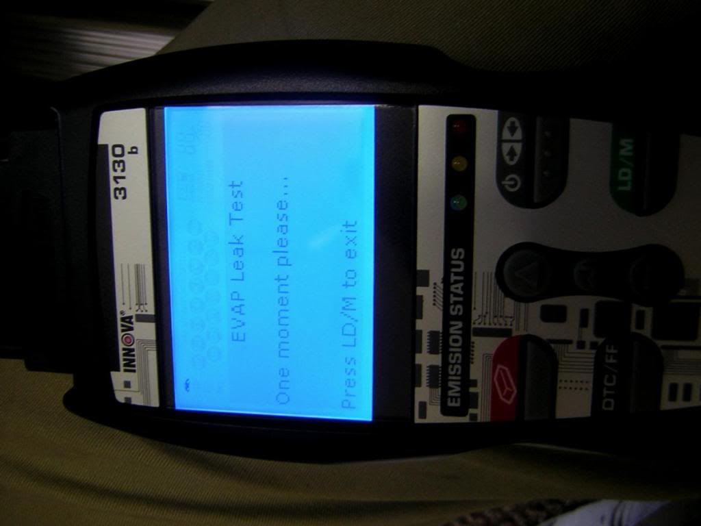

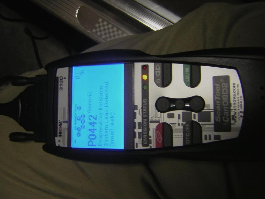

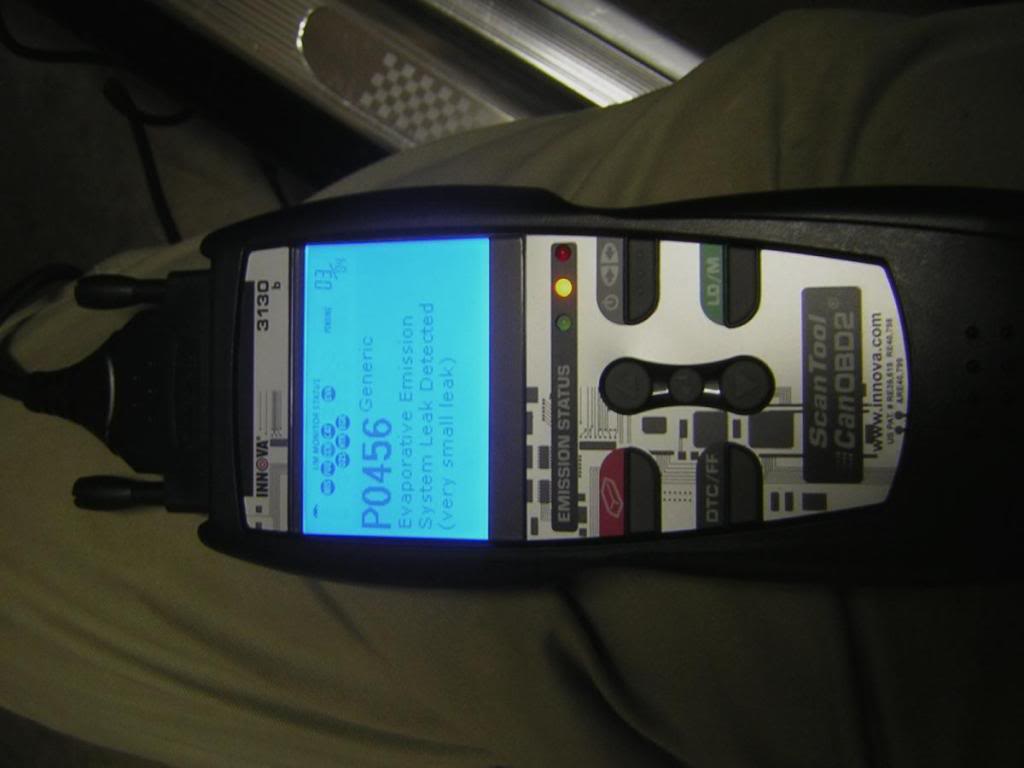

Here are some preliminary results of the 3130. Setting it up was pretty simple and so was connecting it and reading basic results. Note! Some of its more advanced features apply to American and Japanese cars only--a significant limitation. Meanwhile I'm enjoying the basic features and especially the real-time data and graphing etc. Sorry my photography is so crappy.. I was using avail light and didn't want to wash out the display.
First fault codes...looks like a loose fuel-filler cap. Never ceases to amaze me how often this is the cause. Make-work for auto shops since 99% of people have to take their cars in for things like this (a CEL).

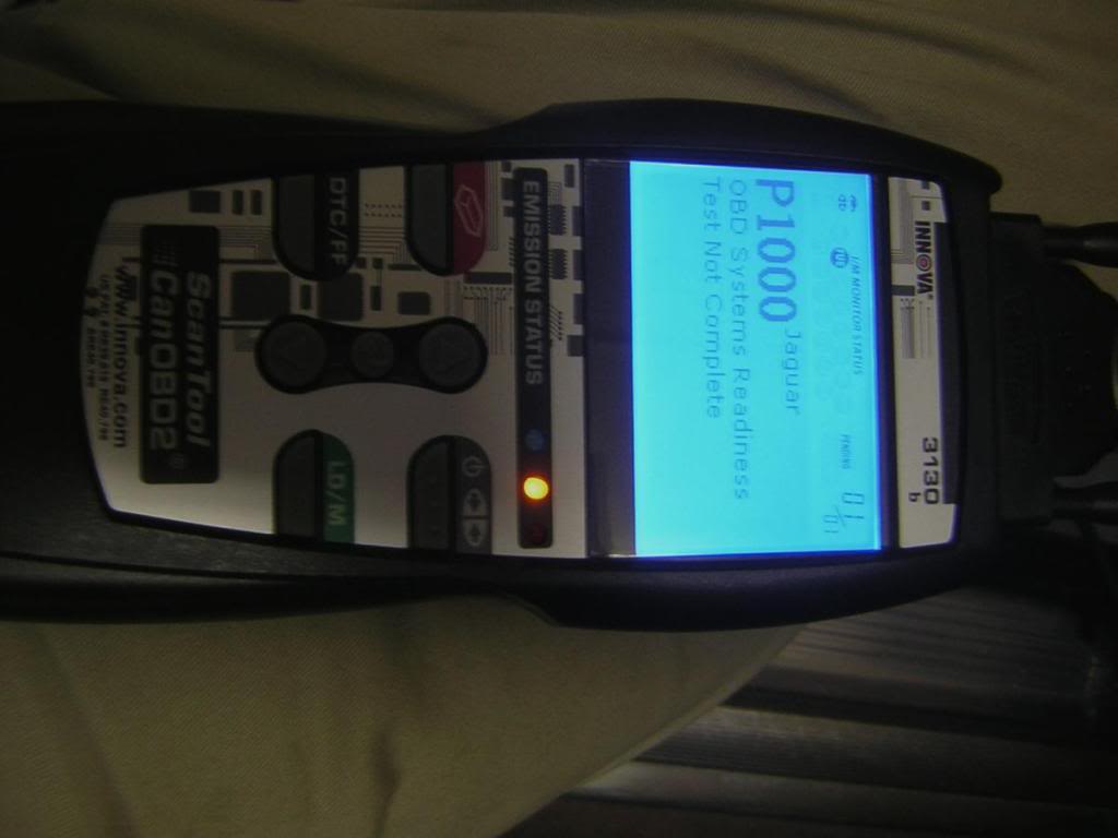

Anyway, the device permitted me to reset and when the engine is started, lo and behold, no CEL!

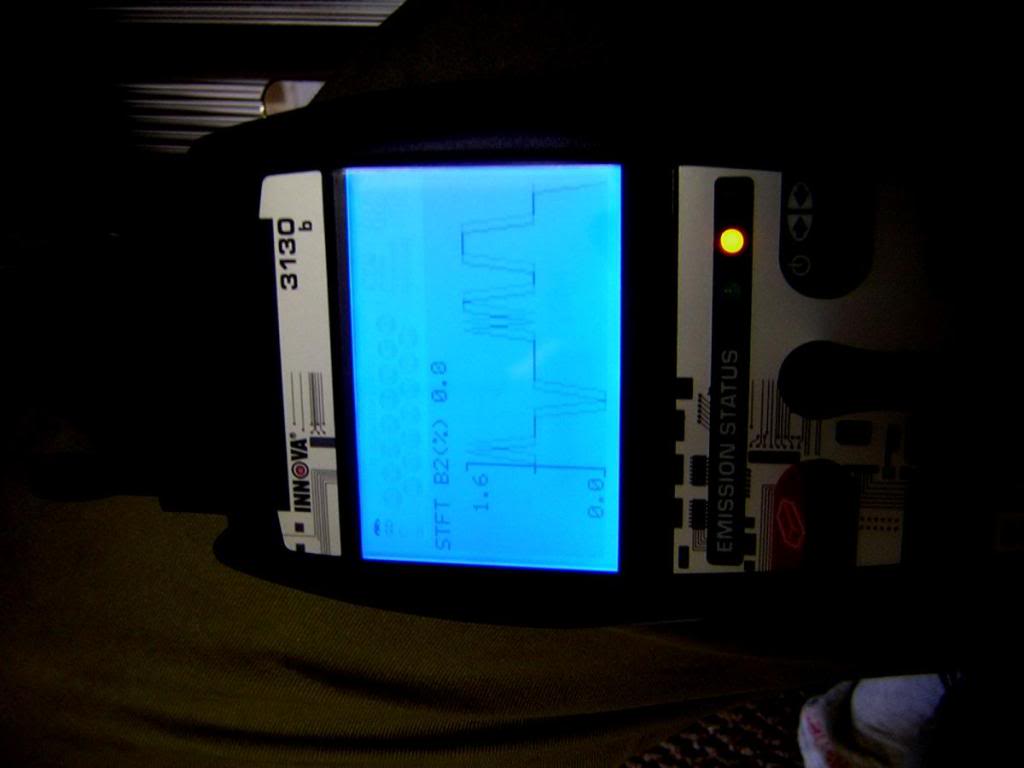

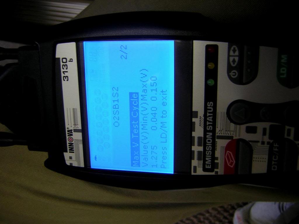

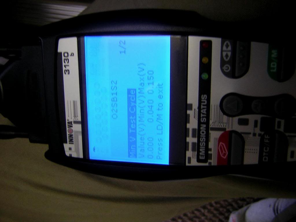

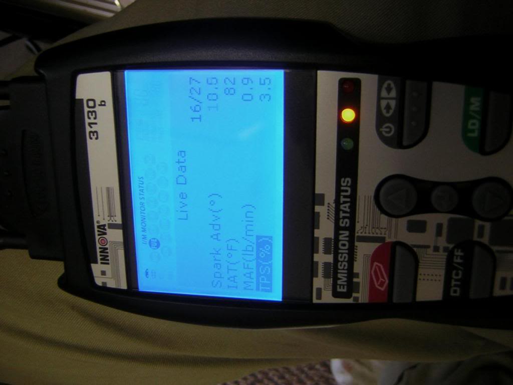

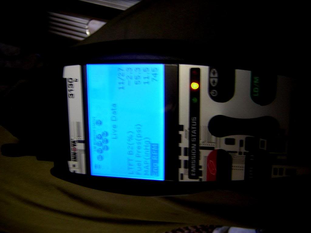

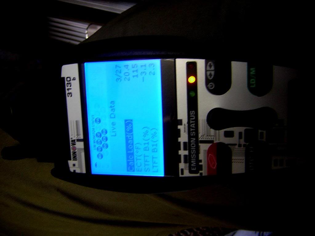

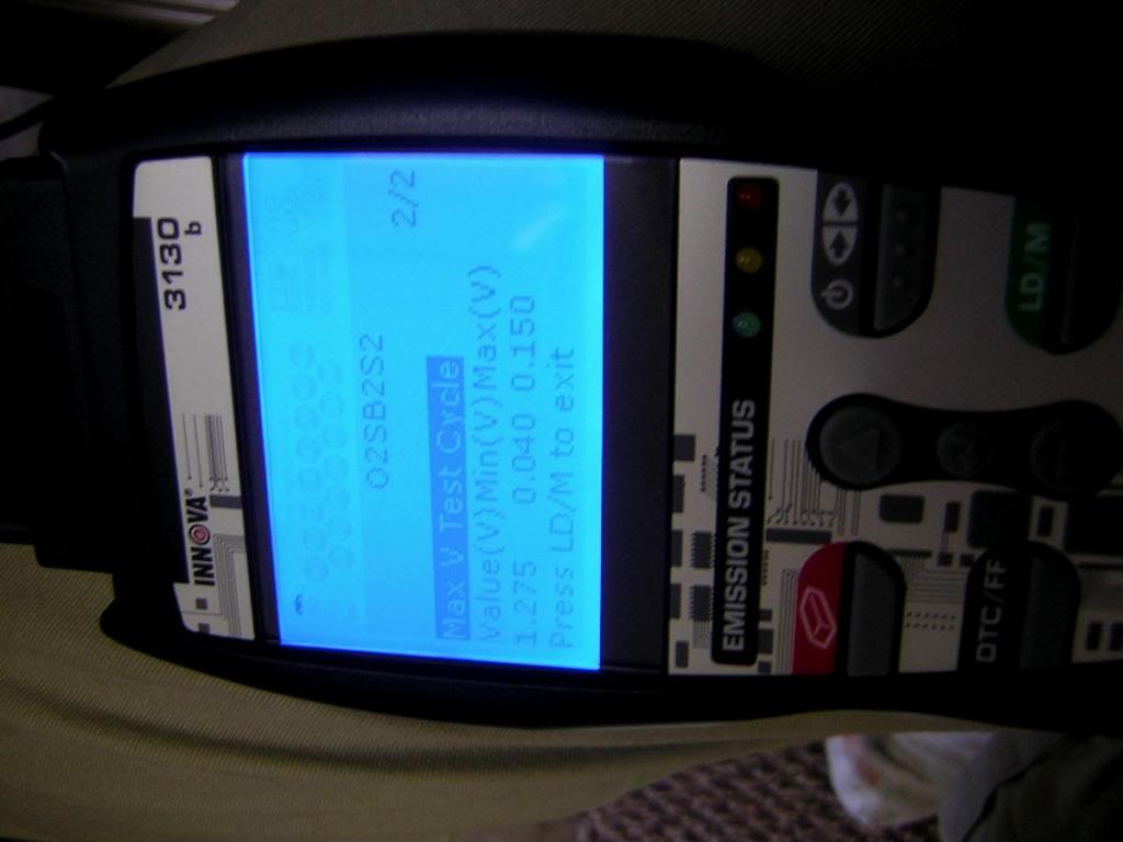

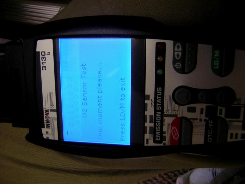

The engine having been started now, you can have lots more fun:Name:  DSCN2930.jpg
Obviously I have a lot to learn. I should have called this post "My First Test Scan" Name:  icon_smile_tongue.gif
Meanwhile: Does this look like it's worth the extra $100 over the model referenced above (by Bill)? Frankly if it's even close, I'd spring for it. The total cost is trivial in relation to the amount of information you can retrieve. My friendly neighborhood Jaguar dealer charges $125 just to read a code so this device has already paid for itself.
