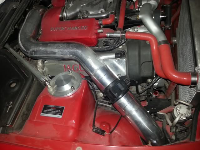

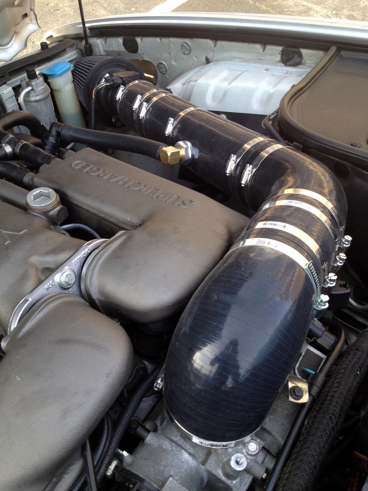

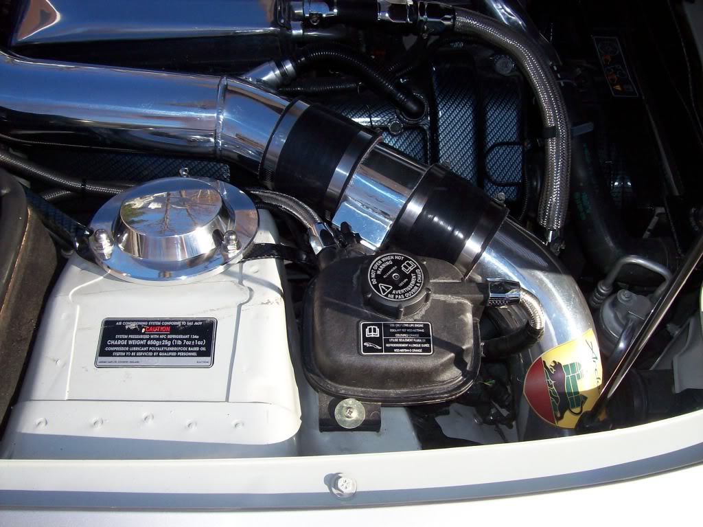

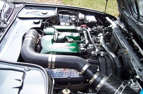

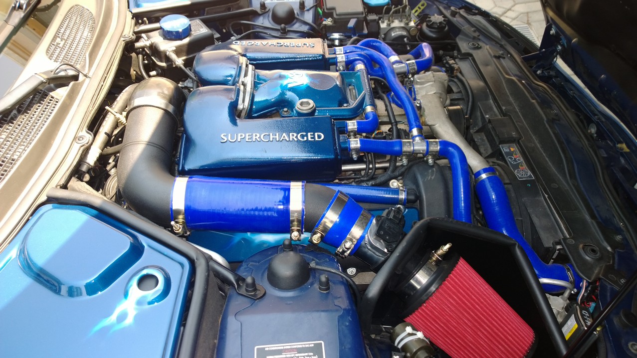

Old Oct 15, 2013 | 04:34 PM
SteveM's Avatar
Joined: Apr 2009
Posts: 694
Likes: 100
From: NY
Something like these:
