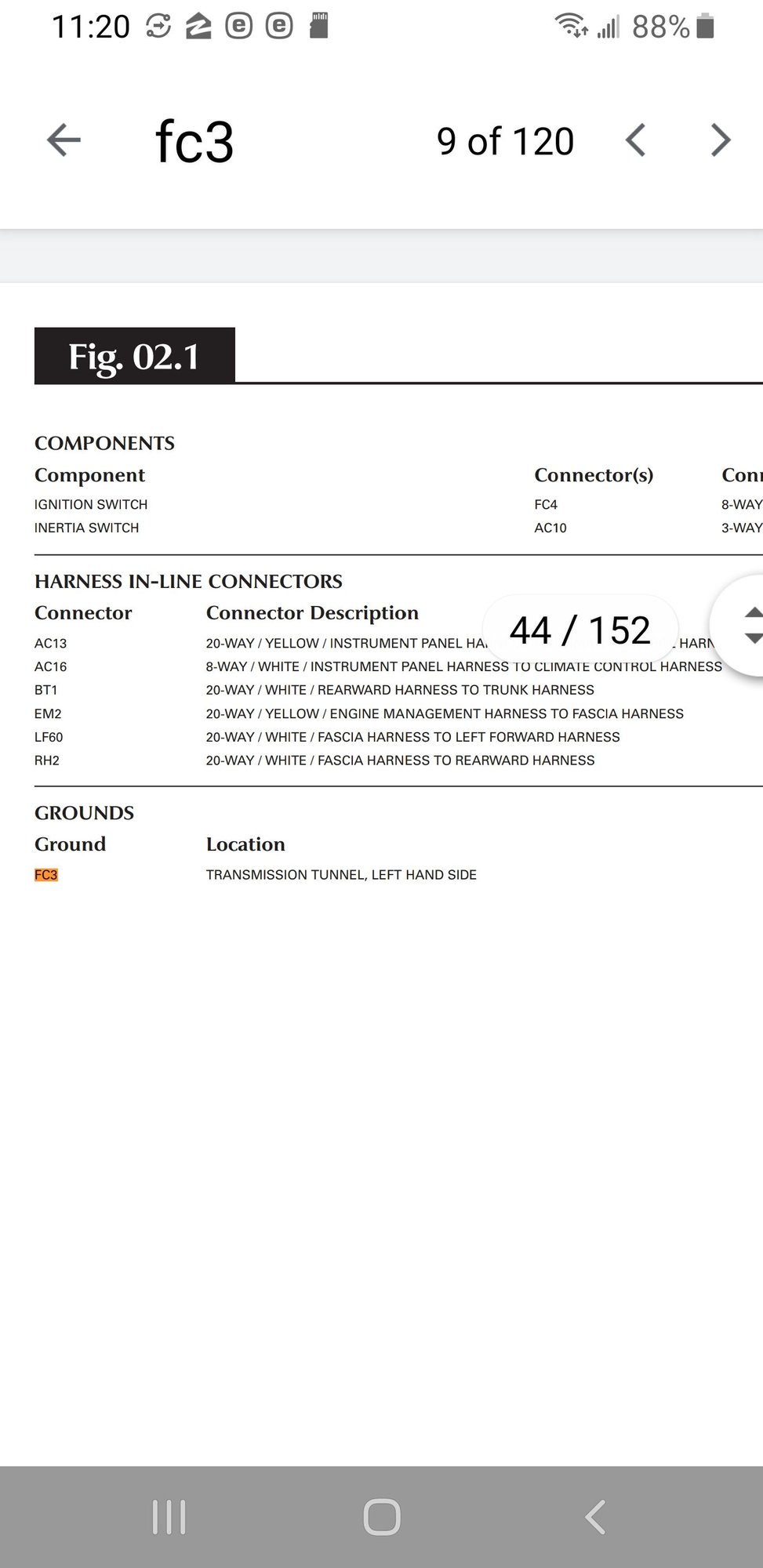

I just took a look. When reading your issues, I thought, whats common here? Ground!?
FC3 (fascia harness connector 3) seems to be common to almost all of your issues.
Search for fc3 if you want to scan diagrams.
Anyway fc3 ground is on left side of tyranny.
John
This may save you time as you scan diagrams.

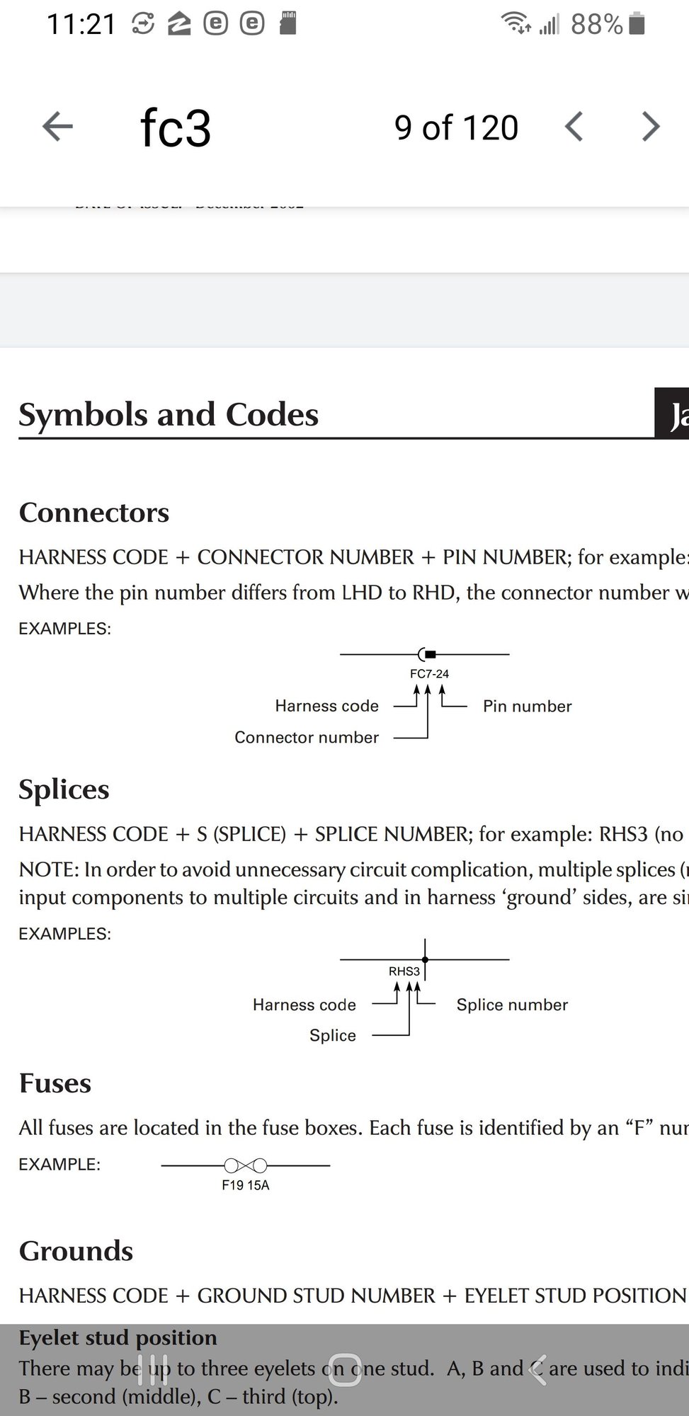

Thanks Johnken - that's a good idea -though it looks like that ground supplies so much the car would not run without it!
I'll take a look as it is a stack of lines -I'm guessing its just lines on a stud not a splice pack.
