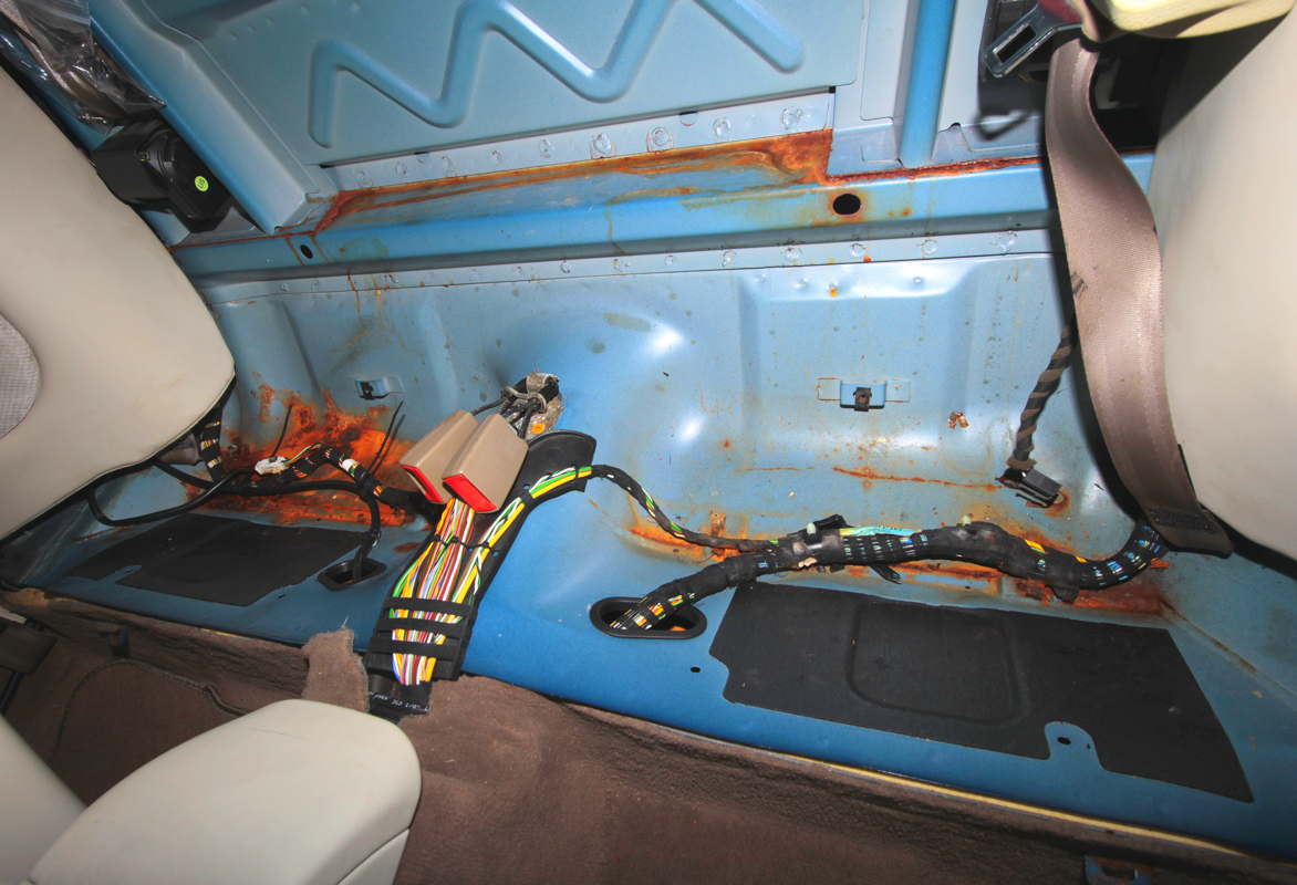

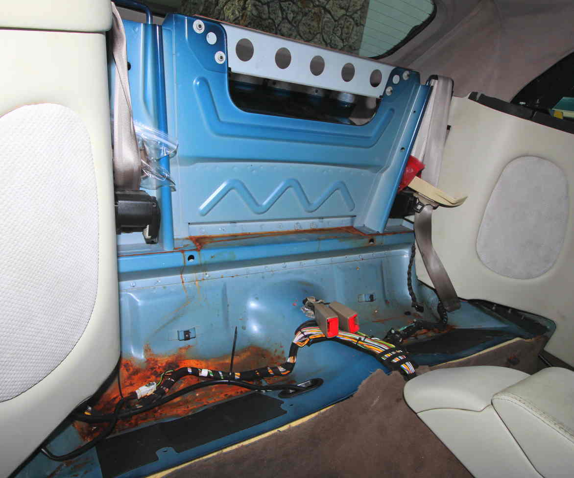

Working on the hydraulic rams of my convertible top mechanism, I found pooled water under my back seat, on both the left and right sides, and quite a bit of it, not just a little, about inch deep (we get frequent, torrential tropical rains here in South Florida, and the XK8 is parked outside). Curious to find the cause since the passenger-side had a fair amount of rust, I've left the back seat removed until I can find the cause of the leak.
Water poured along the sides of the convertible top appears to run inside the fender space and pour out of two drain holes on the underside, a few inches apart, at the seam where the sheetmetal of the fender(s) and underbody meet, in front of each rear wheel well. There is no 'drain line' apparent that I can see (that might be clogged), even though I have seen diagrams that indicate one on each side of the top; maybe proper drain lines are indicated for model years other than the 2000...?
Anyway, in a different part of the forum someone found that water under his back seat was caused by water leaking around/through the rubber seal of the rear window. I have noticed a barely-visible dry water stain on the inner lining, just below the rear window, which might seem to back his conclusion. But what is the exact vector for the water intrusion?
The previous owner of my XK8 kept it garaged (15 years), and the rear window seal looks faultless (as does the convertible top itself). Thinking that the issue could be water soaking through the outer top material and then running along the inner rubber layer to be dumped, and overwhelm, the seals at the back, I decided to waterproof the top and see if it mitigated the pooling water issue, as a drop of water applied to the top is adsorbed immediately; it does not repel water at all.
Reading though most, if not all, of the pertinent forums here, and everywhere else online for a week, I decided on the 303 Convertible Top care kit for cloth tops (includes special cleaner and fabric sealant). Procured from Amazon for $24.57 USD, here:
Robot Check Robot Check
Followed directions; cleaned and applied.
The water beaded and was repelled at the first brief light rain, but hours of steady rain several days later and the top again soaks through, virtually none of the rain beading off. CURSES!! (The water only leaks in and pools under the back seat after hard and/or prolonged rains, never after light rain.)
Back to square one; and thoroughly NOT IMPRESSED with the vaunted 303 product! (I used the entire 16 oz. bottle of fabric treatment).
Any helpful suggestions from better-informed and seasoned convertible owners would be much appreciated!
(The included photos are color-enhanced to better show the areas where the leaks are evident.)

Originally Posted by Sir Alex of Yotto
... The water beaded and was repelled at the first brief light rain, but hours of steady rain several days later and the top again soaks through, virtually none of the rain beading off. CURSES!! (The water only leaks in and pools under the back seat after hard and/or prolonged rains, never after light rain.)
The convertible top itself, without 303 or any competing product applied, should be water tight. The material it's made of has a rubber layer inside. Similarly, If water is getting in, 303 cannot cure it. If the material is not torn, I think you must have a leak somewhere at the perimeter ... all the places where the top seals against adjoining surfaces.
But that said, my experience is that 303 is an excellent product. Properly applied it lasts about 6 months. Its primary benefit is UV protection; the water beading serves primarily to let us know when it's time to apply more.

Originally Posted by Dennis07
The convertible top itself, without 303 or any competing product applied, should be water tight... ...my experience is that 303 is an excellent product.
As Dennis said, your top should be waterproof without ANY protectant on it... so it seems as if you have a bigger issue going on.
I used 303 as well and it is tops in my book (pun intended)... It has been over a year and a half since my treatment and it still beads water like a champ (but my car is in the garage 99% of the time).
If you want to meet up I can give you a second set of eyes to see if we can find out what is going on... just let me know.
