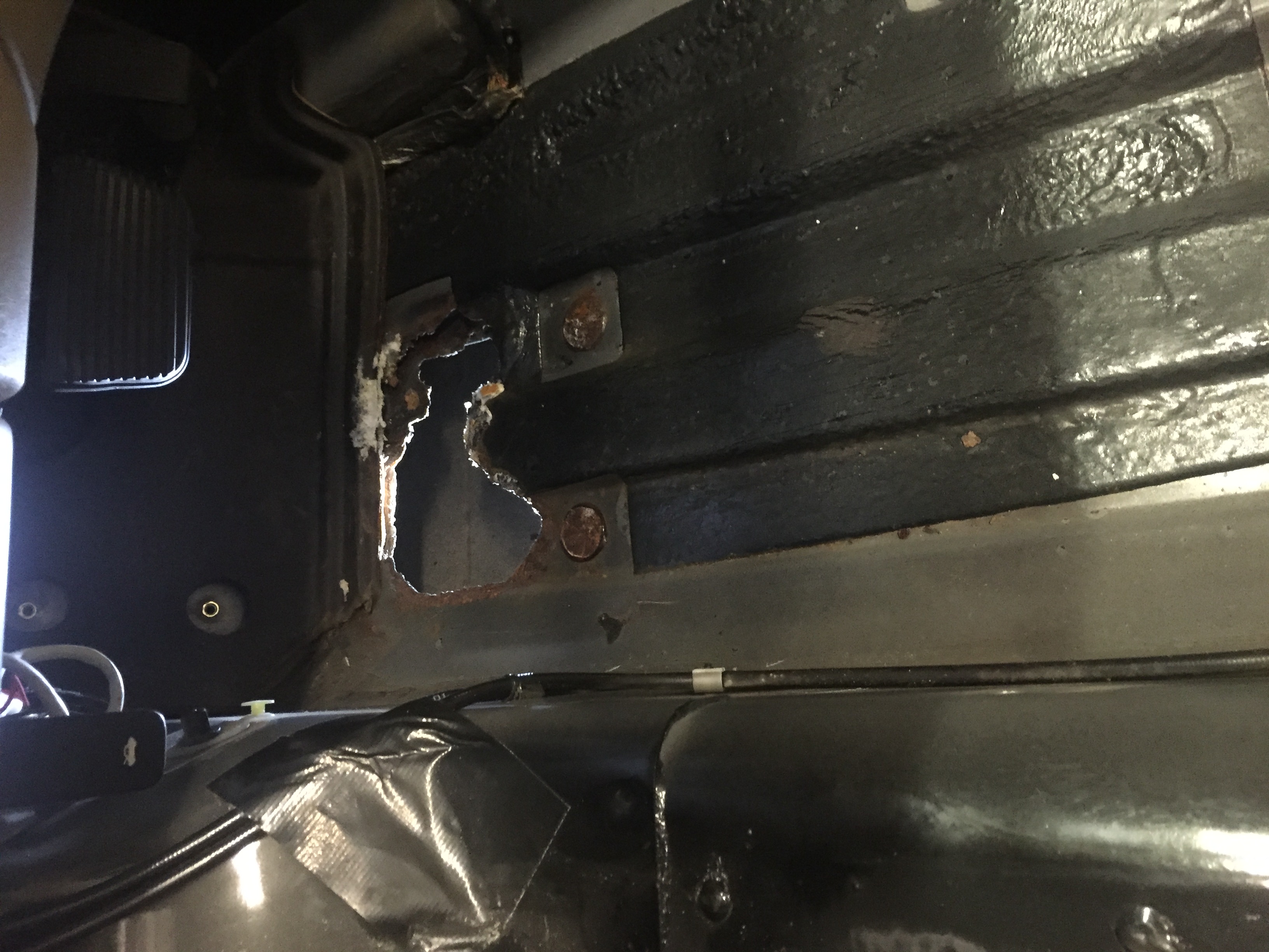

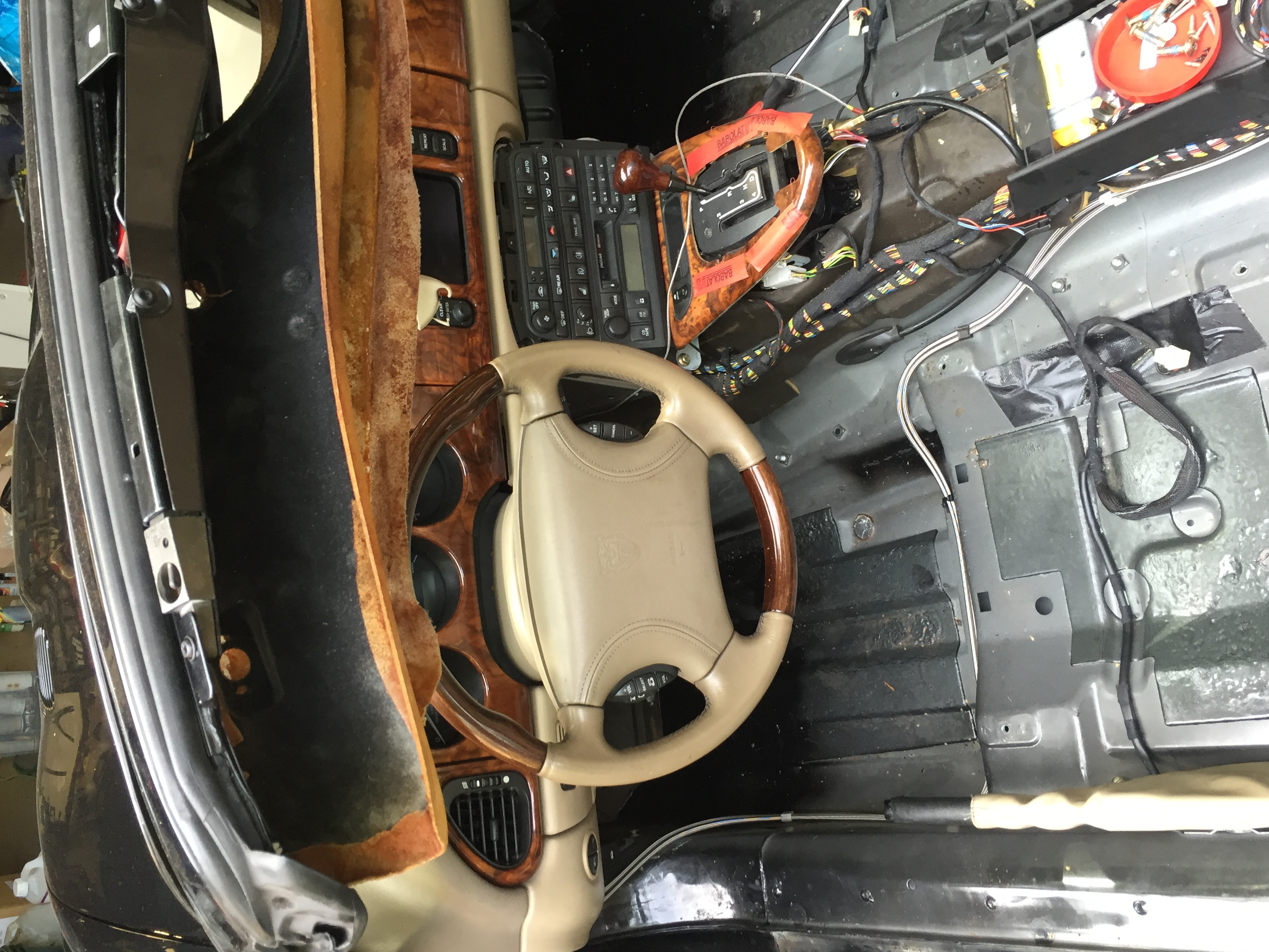

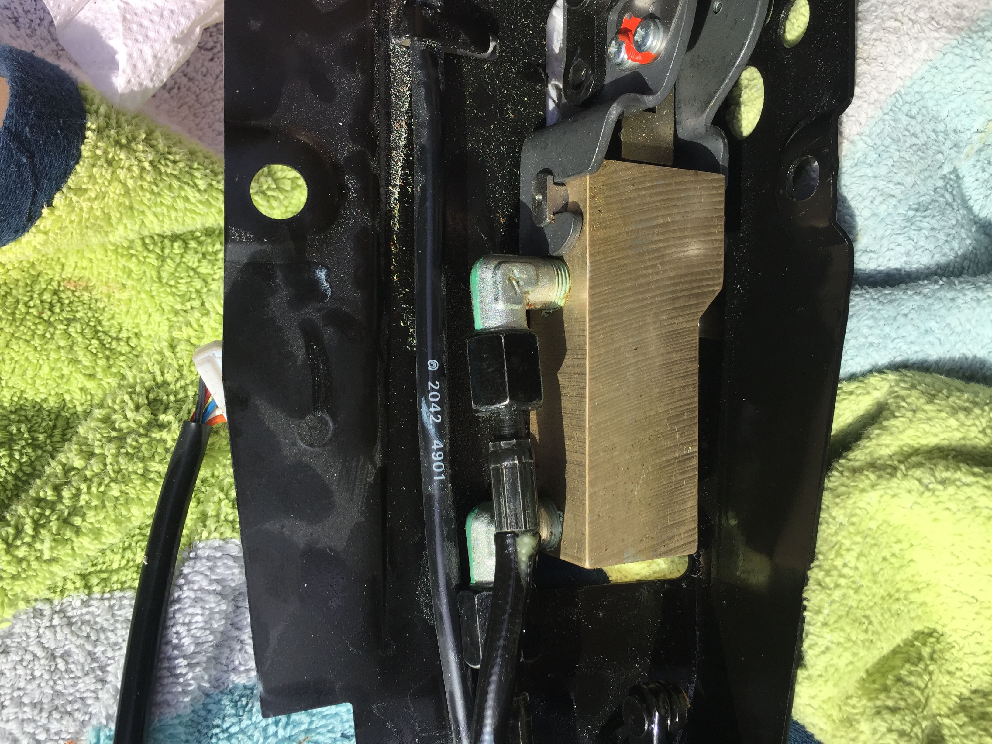

I have been very lucky today!
Last week my car failed the yearly car checks, as the ventilation hole (foot rests almost gone) where a tad too big on both sides. Knew it was, but never took the time to fix it, so now I had to do it within 2 weeks.
Friday I got my car back from the welders, and today I started to get all the floor lines etc back in.
As my convertible roof has been used a lot in the summer, I considered to replace the hydraulic hoses as a precaution (bought 5 years ago), even though I have the pressure relief kit already for many years as well.
I actually choose not to do it, and expected it would last much longer and take my chances
Well today I started painting the new foot wells, and opened the roof for it.
Guess what happened next ;-)
After a little while I got the green shower, at the typical place everyone had theirs go (connector to the latch).
So my luck that I not only had already the new hoses (the new shiny hoses in the picture), but also that the car was apart already.
Herewith I want to thank Gus again for his work, as I bought the hoses he recommended back then!
Unfortunately the pressure relief valve is not a guarantee, but I am very sure my original hoses lasted much longer for it, and I have left it in place now as well.
