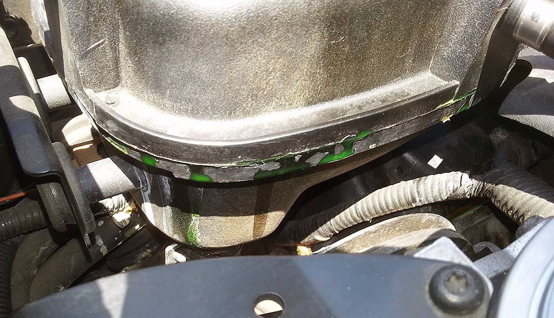

Since I bought my xk8 used, I've noticed a faint coolant smell after every use of the car. I finally noticed that coolant is weeping from the seam in the tank, very slowly in small amounts.
Rather than buy a new Jag tank for $150-$250 which will eventually have the same issues, I am thinking about getting a welder to make me one out of aluminum. If he can do a good job, I might recommend him to others here... as I'm sure we'll all have leaking tank seams sooner or later.

My question in all this is: Why replace it unless it's leaking? I don't often replace $200 parts unless thay are showing a failure mode. Belts and hoses are good PM things but XK8 coolant tanks are low wear items and I have seen little indicating that they all fail at some particular point. The ones for the XJ8 x350 are another matter, they are a common failure point and replacing them at about 60k is just good PM.

I missed the reopening of the thread. As far as the leaking seam goes, it is likely not a leaking seam but a weak tension clamp on one of the hoses that just dribbles and makes it look like a leaking seam.
I wish it were that simple, but sadly I watched as coolant bubbled out of the seam on the side There was no coolant dripping from above the seam anywhere, only through the seam itself.
I suspect many people who "smell coolant" but cannot figure out where it's leaking may have this same issue? It took me a while to notice this because I had to be on the passenger side of the engine bay while the engine was running (not something many people do).

I got lazy & haven't made any progress on commissioning an aluminum tank. My car sensed my complacency, so it decided to teach me a lesson
I was driving along in the 100+ degree heat, when I heard a faint pop. About 30 seconds later, steam started billowing out from the hood so I pulled over & stopped the motor. Peeking under the hood, I discovered that the tank completely separated in two (at the seam), throwing all the car's coolant over the engine
