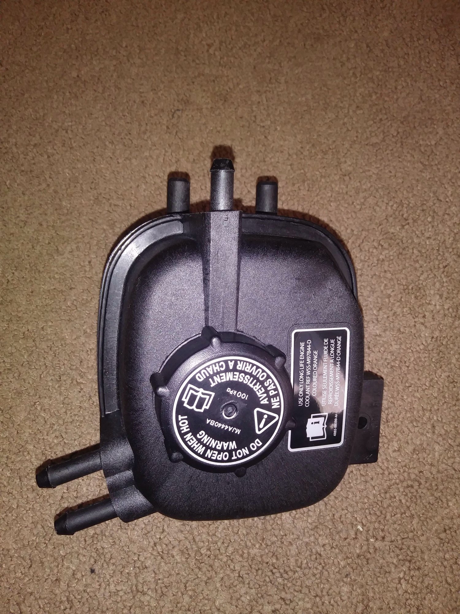

Yesterday afternoon I discovered that my wife's 2006 XK8's coolant expansion tank has a pinhole leak, probably on its underside plastic nozzle since that is where I discovered a small amount of orange-colored wetness by feeling the area with my index finger. When the engine is hot, a single droplet of coolant oozes out underneath the tank every 60 seconds or so, falls to the hot exhaust pipe below, and instantly vaporizes into a sweet-smelling steam puff that visibly rises up through the drivers-side hood seam. That is how she first spotted the issue after pulling into the driveway, shutting off the engine, and remaining in the drivers seat while finishing up a phone conversation. Once the engine bay cools down enough, this pinhole leak stops....
I ordered a replacement tank (part no. MJD4400AB) from rockauto.com for about $58 including shipping and it should show up here early next week. Knowing the infamously lousy plastics used in these cars, I am surprised and pleased that her original factory tank lasted more than 12 years....
For those of you who have already done this job, any tips and tricks on how to replace the tank while minimizing the coolant mess created during the process would be much appreciated....

I did the coolant expansion tank replacement job first thing this morning. Pumping out the contents of the old tank first leads to much less coolant spillage during the process. I was extra-careful with the small metal clip which secures the coolant temperature sensor electrical connector into place. Before removing the clip, I covered the area below it with an old towel so that if it did spring away from me, it was likely to be stopped and trapped in the towel. As I worked the clip loose with a small flat-head screwdriver, I made sure I had the top edge of the clip tightly pinched between my thumb and forefinger. Fortunately I never lost my grip on it during either the removal or the installation so I never had to go hunting for it. Once you have the clip pulled slightly out of its bracket you could run a section of fishing line through it and tie it off so that if the clip does decide to fly, it will remain on the end of your line. I thought about doing that but was confident enough that I would not lose my grip on it....
The 5/16-inch rubber fuel line that I had used back in November 2014 to replace the original lousy plastic breather hose between the thermostat tower and the coolant expansion tank had already baked into a hard, brittle, inflexible hose that refused to pull off of the two plastic nozzles it attaches to on either end. So I decided to sacrifice this hose, slit its ends with a box cutter, and easily pulled it off that way. Keep in mind that whatever you decide to use for that breather hose just sits there and bakes above the engine and underneath the engine dust cover - not an ideal environment for any component. In an effort to find something more robust that may tolerate the engine heat somewhat better, I made a quick run to Advance Auto Parts and came back with a 3-foot section of 5/16-inch transmission fluid rubber hose. We shall see if that also bakes into a hard, brittle line after just a few years. But since fuel runs through its lines relatively cool while transmission fluid runs through its lines relatively hot, I figured it is worth a try for the $6 it cost me....
After getting everything back together properly and double-checking my work, I started the engine and let it run for 10 minutes or so. No visible leaks. So my wife took off on her initial test run and returned about 10 miles later with no issues. I will leave the engine dust cover off for a few days and inspect all the fittings very carefully after each drive cycle to ensure that the new tank is functioning properly and all hoses are leak-free. I expect to have to top off a small amount of coolant each day through the weekend in order to bring the system back up to normal. Time will tell....
