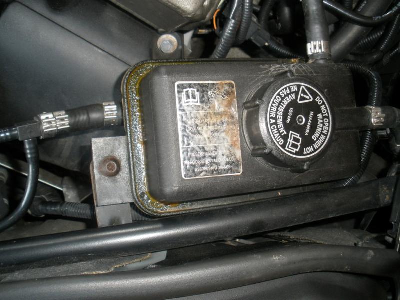

I've got an irritating coolant leak
Judging by the discolouration of the top label it looks as if the cap is leaking
Bearing in mind the nearest dealer is over 100 km away is it worth changing the O ring or are there other internals that might be leaking?

Steve,
The cap is listed separately so it must be a fairly regular failure although most of us seem to have cracked tanks before that stage.

That definitely appears to have been leaking past the cap seal from the way the top of the tank is stained.
Different tank on the SC but the NA usually splits on the bottom, presumably from the heat of the exhaust over time. If this is the cause, the SC tank is likely to fail in a similar location.

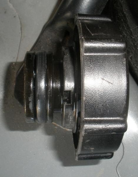

I think I've sussed it.
The cap is (as one might imagine) quite ingenious.
The lower O ring in the pic seals to the lower part of the tank neck.
There's a tiny brass poppet valve. When it opens it lets the tank contents communicate with the slot above the O ring.
There's a second O ring up inside the cap so the slot is sealed into the part of the neck where the overflow pipe goes in.
The upper O ring on mine had given up its little rubbery ghost so a small amount of coolant seeps past it when the valve opens.
I've replaced it so - hopefully .....

Steve looking at your picture of the tank it looks as if the hose in the top of the picture maybe leaking around the clap. Looks like a little corrosion wear the hose meets the tank. Try a new hose clamp. .70 us Ha Jim

Thanks Jim, I'll have another look.
