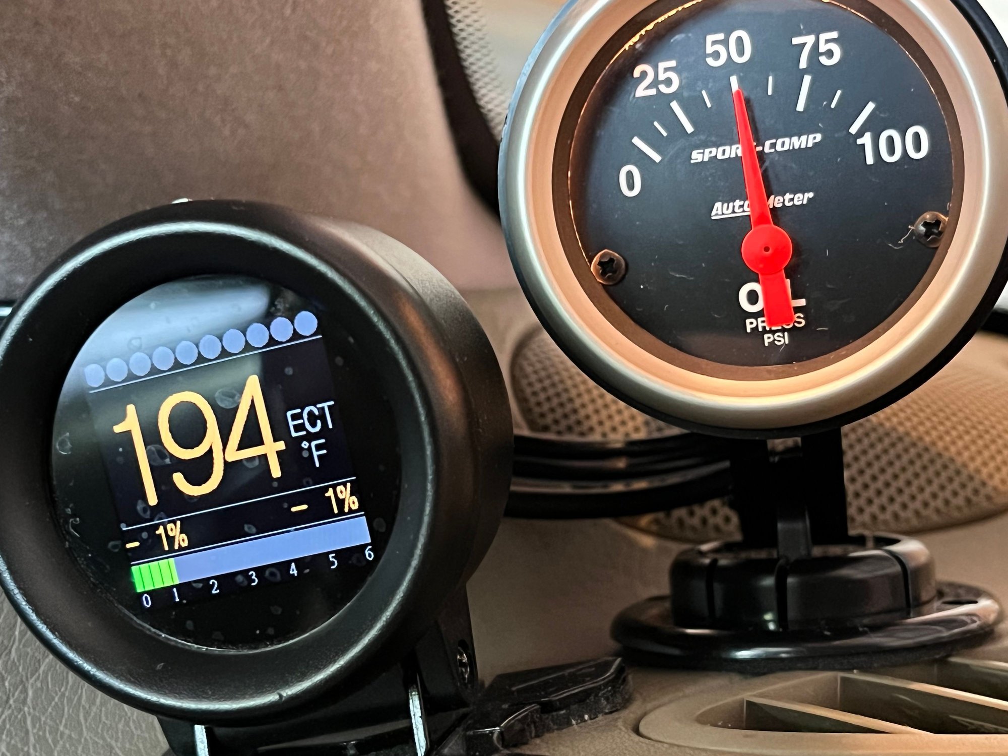

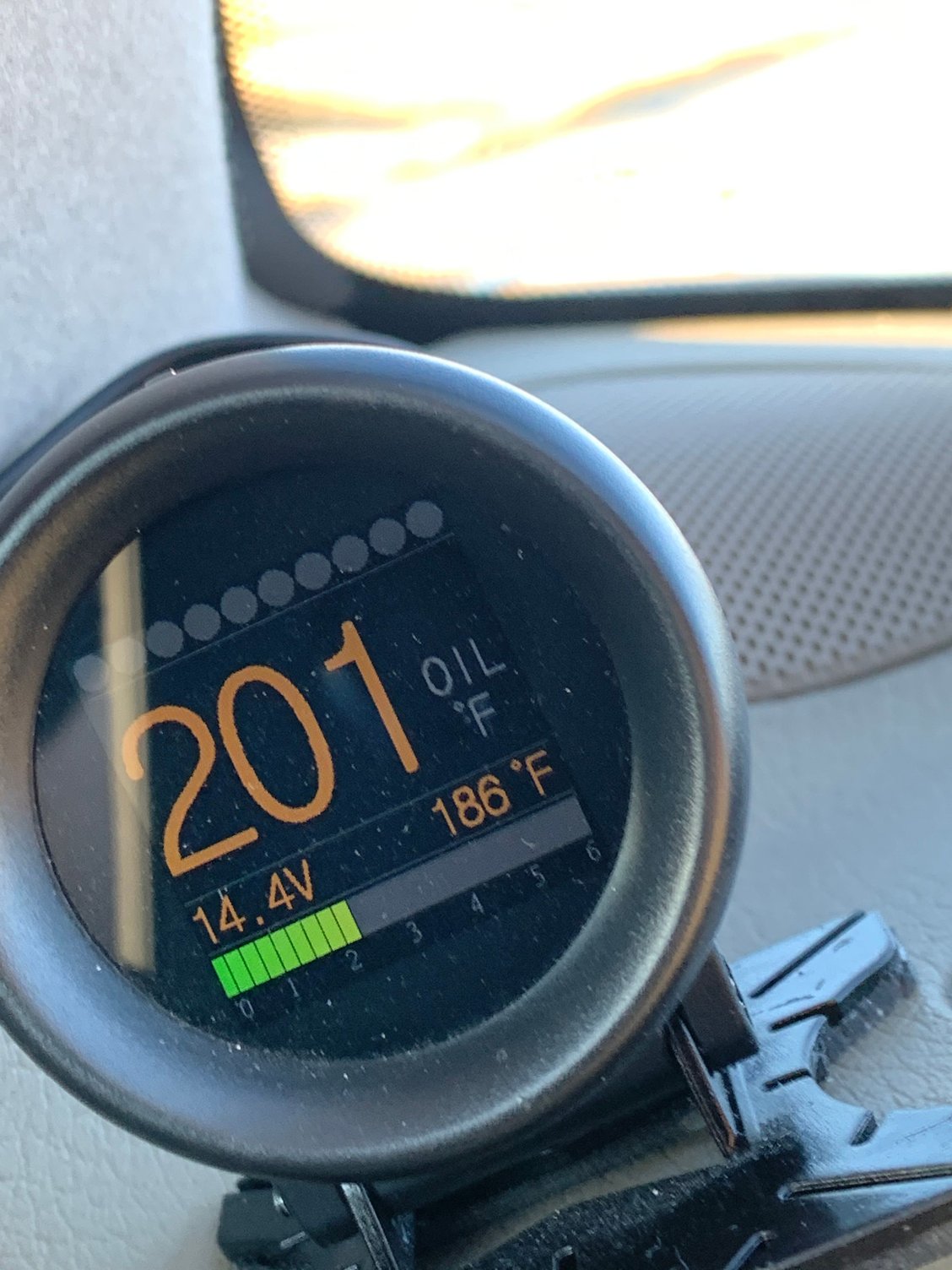

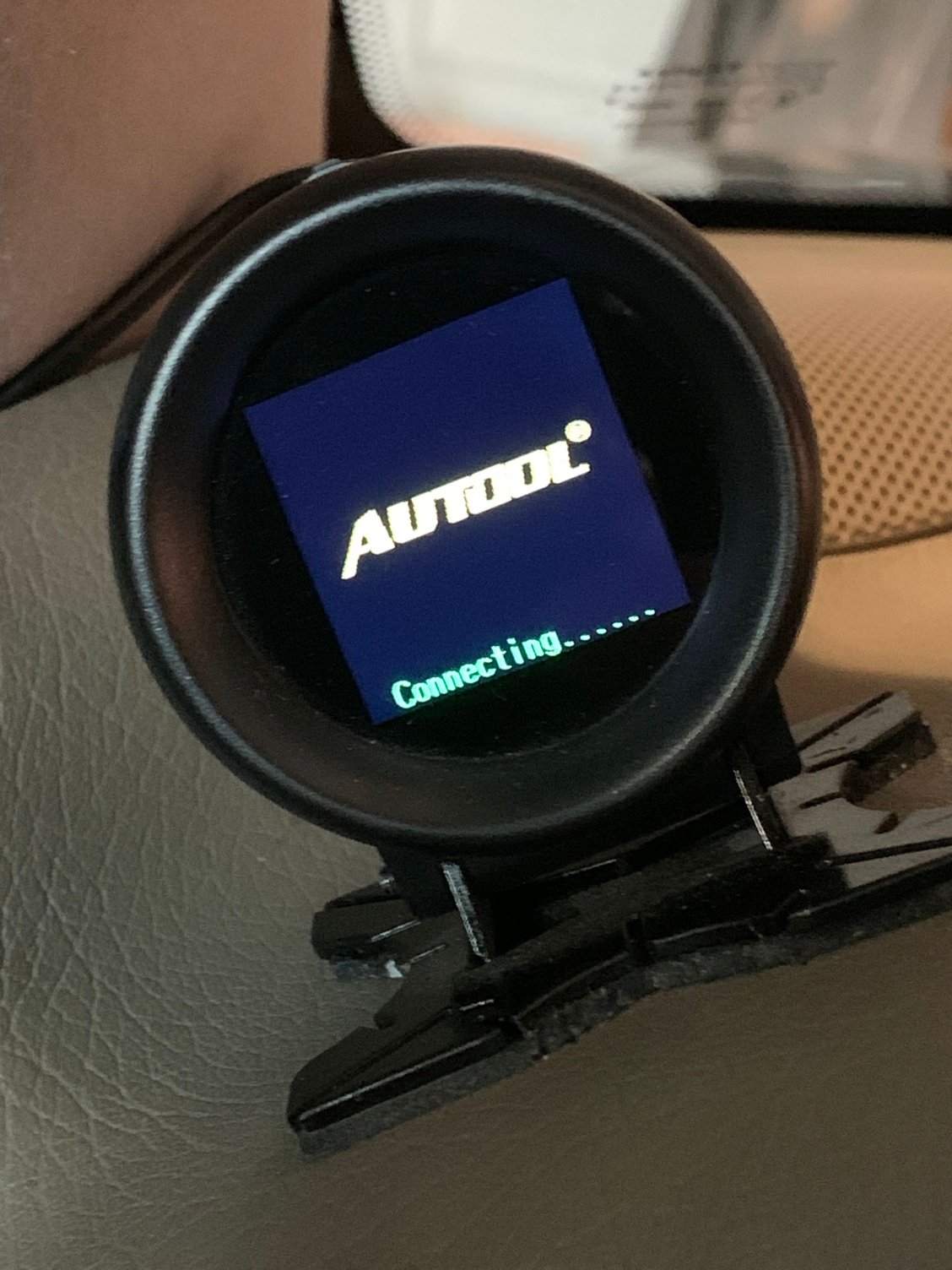

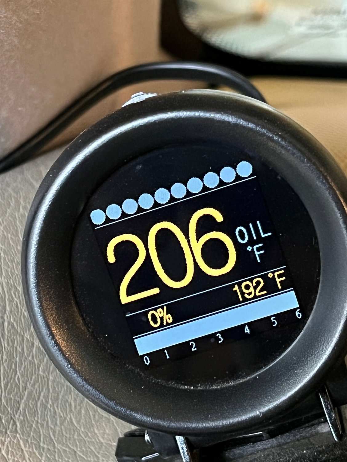

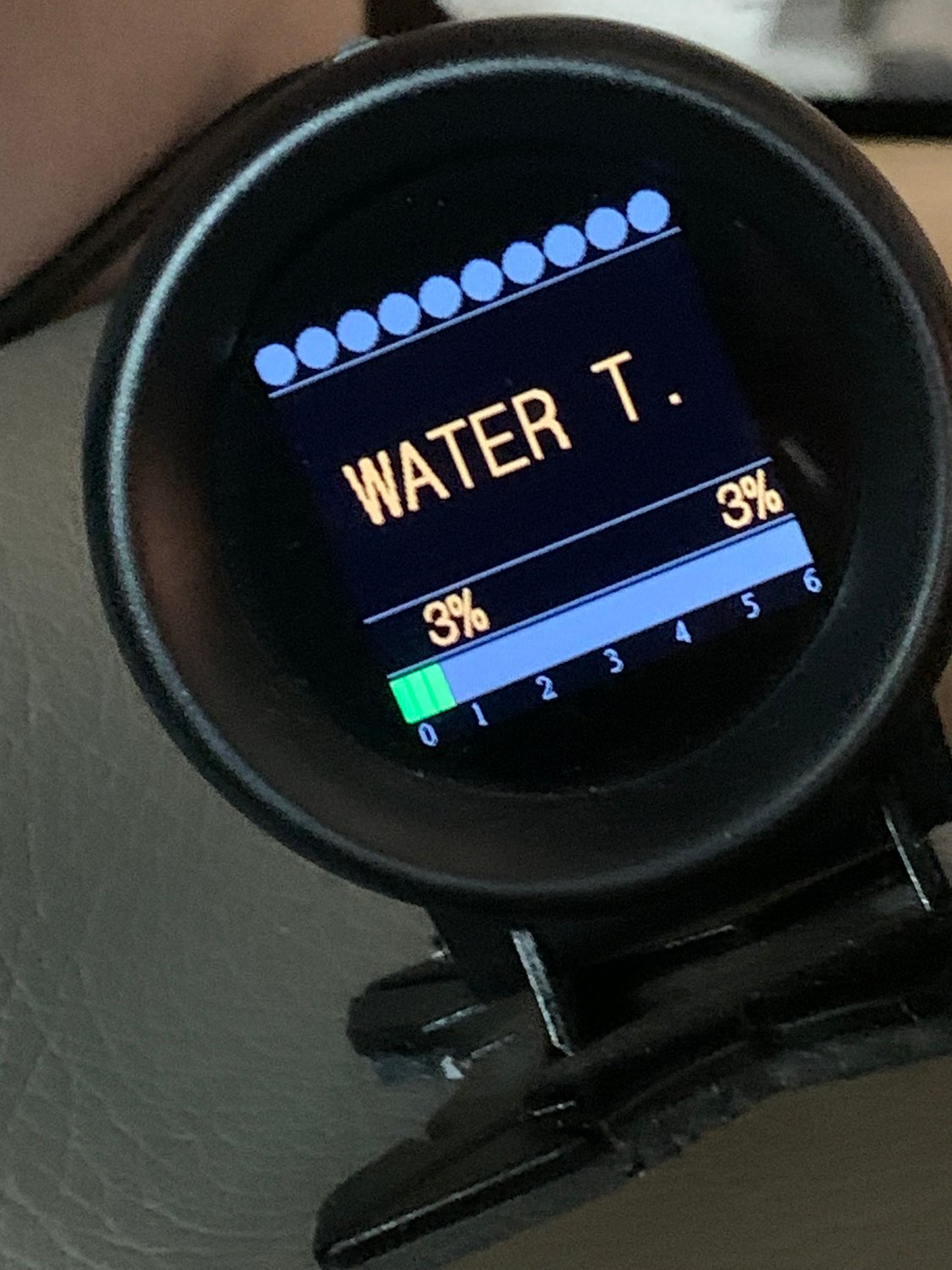

Oct 16, 2025 | 09:00 PM

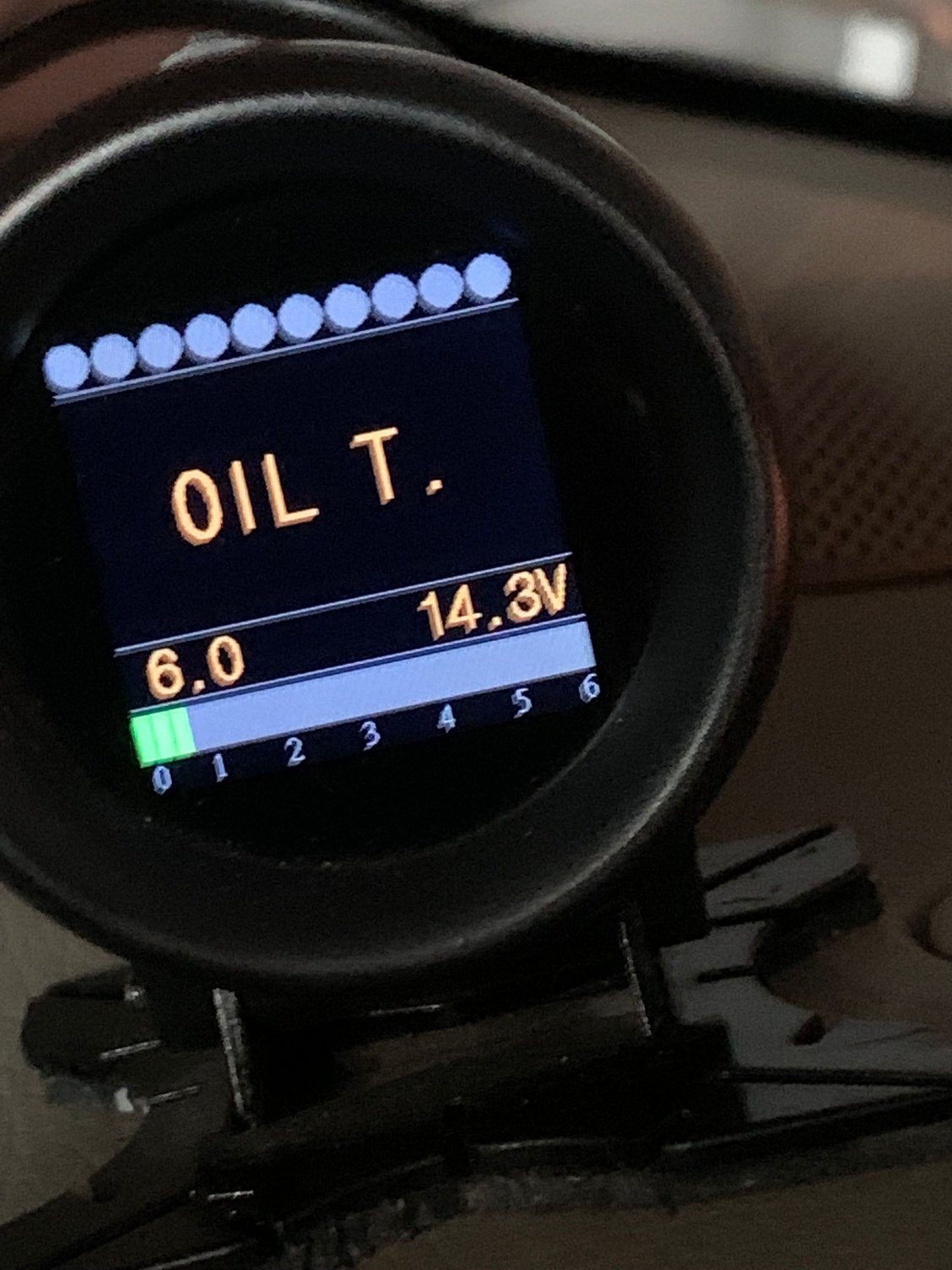

OP, you might want to invest in an aftermarket gauge that plugs into the OBD-II port and can temporarily, or permanently, sit on the edge of the dash.
i chose permanent. I’m a sucker for gauges. Besides coolant temperature, the one I purchased will display oil temperature, fuel trims, and many other parameters too numerous to list. Most everything except oil pressure.
Amazon sells them for about $40-50.

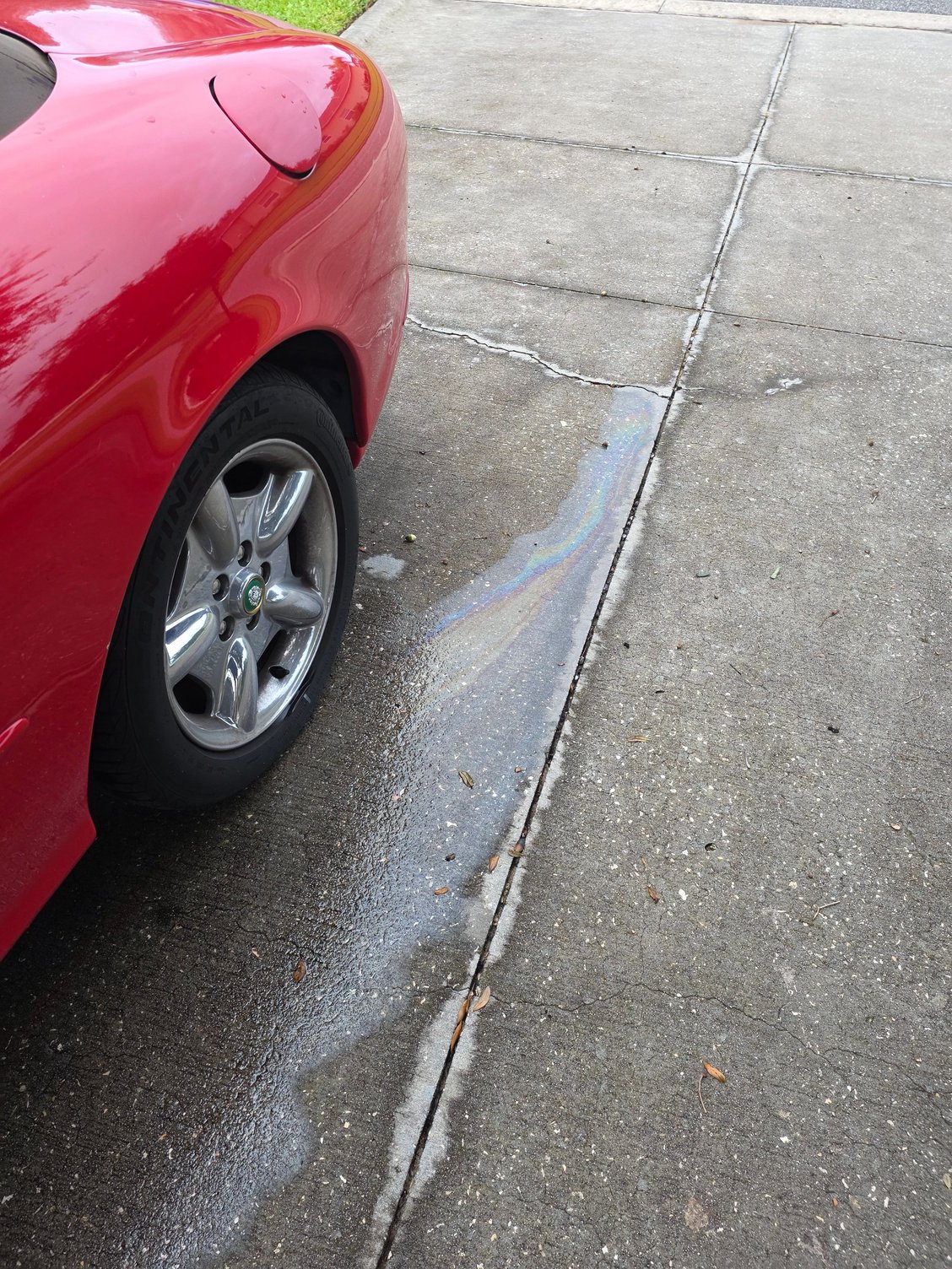

Oct 26, 2025 | 06:23 PM
  #37
So last time I worked on the car was about a week ago, and the coolant system had been thoroughly flushed with distilled water, like ive gone through 5 gallons of water. The system should be solely water at this point. Today i went to pull the thermostat to test it, and also to try the compression test, but it looks like the water answered the question for me. Clearly oil has been seeping into the cooling system all week. Time to buy some headgaskets!
