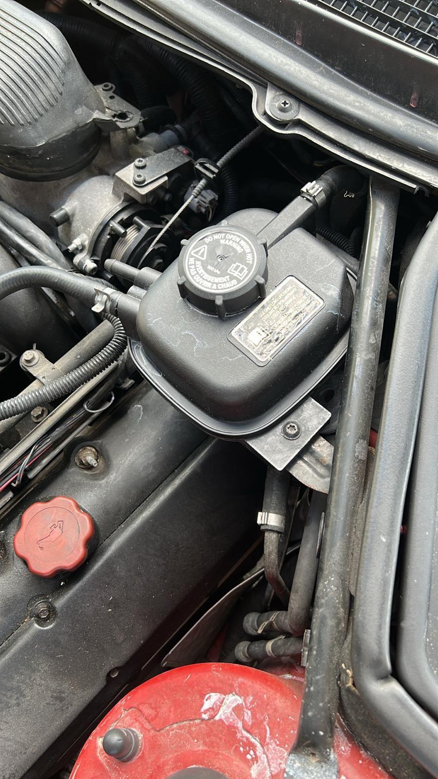

The connections on the coolant reservoir are likely crossed/incorrectly routed.
does this not look right? Its a late 99 model. Thank you

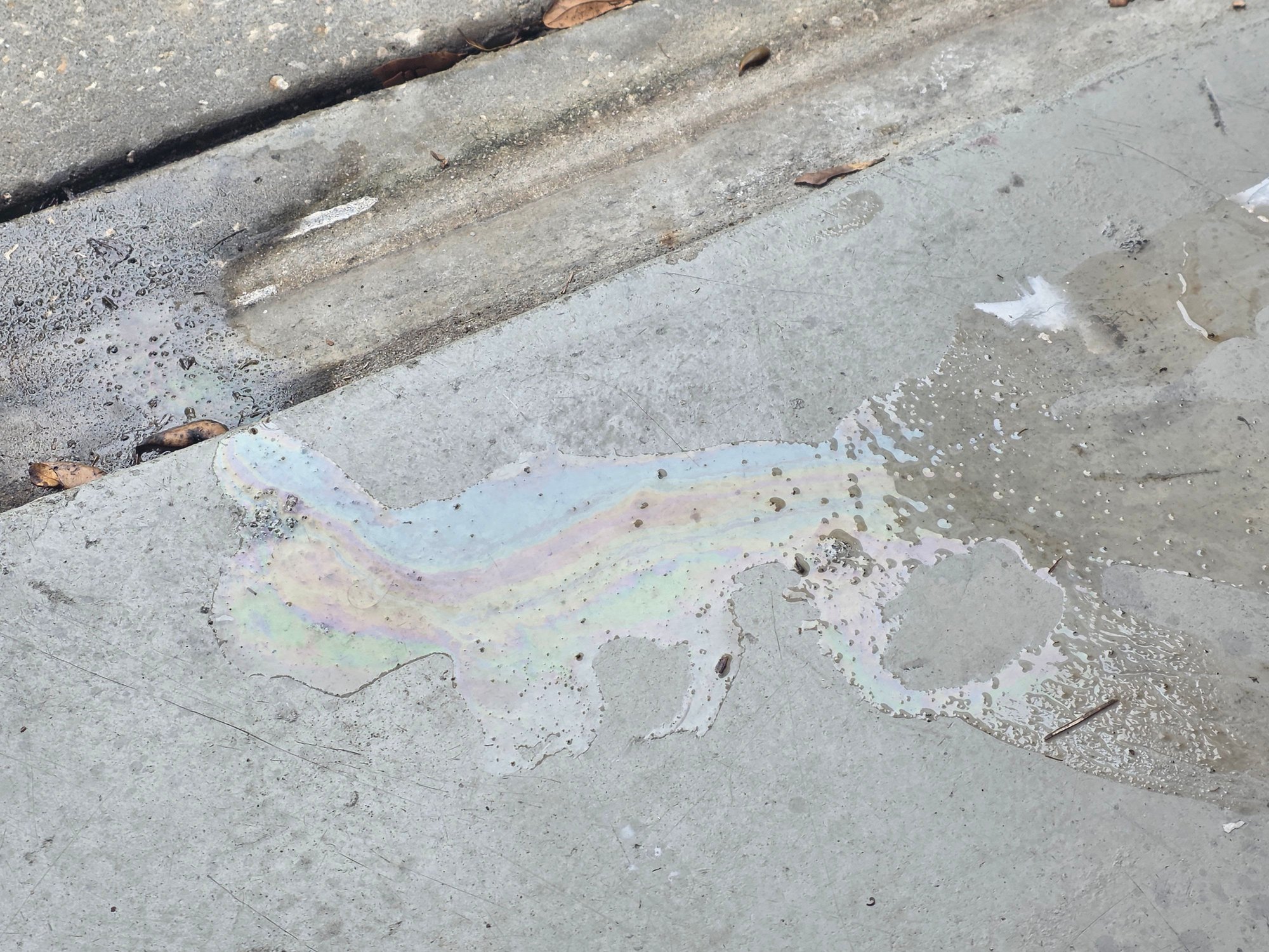

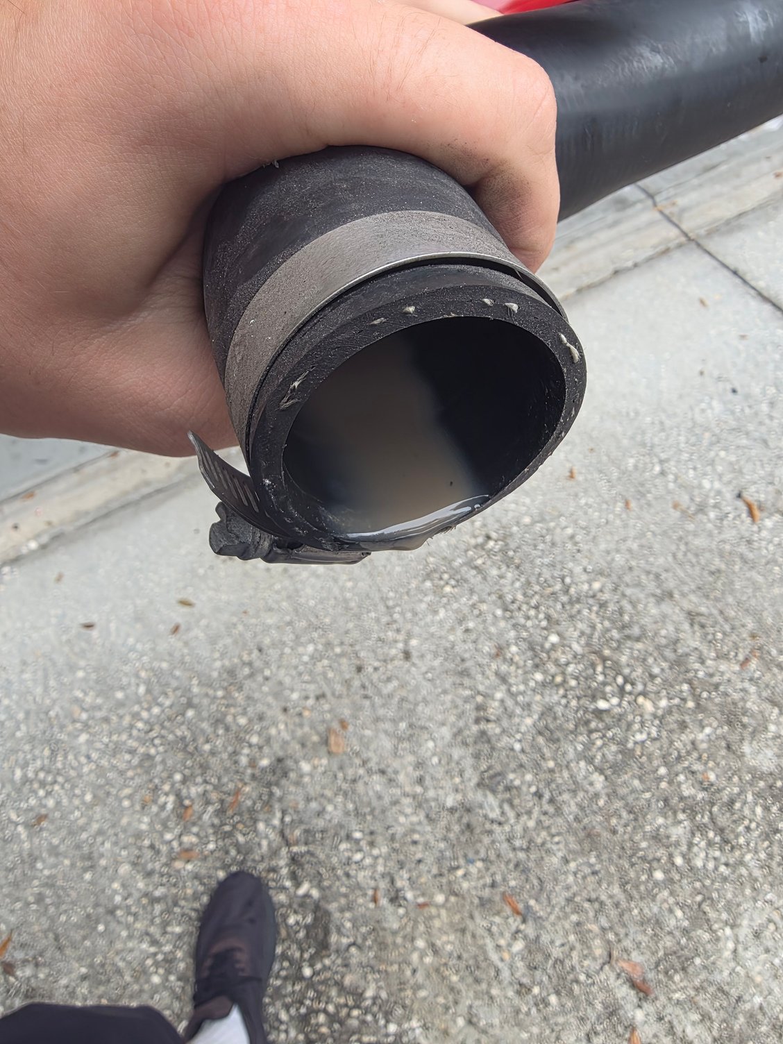

Hmmm, if thats what your leaning towards, do these photos help your theory? When i did the first flush the coolant looked very odd. But the oil was perfect.
That does look correct!!!(never mind)
Yes, that coolant looks really fishy. Kind of oily too. You could just have a bad water pump, but with an engine of unknown provenance, it's best to cover all the bases.
