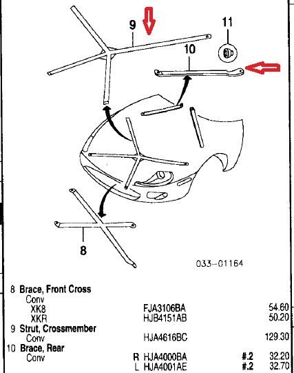

I was wondering if anyone could point me to the torque requirements for the bolts that hold the front cross brace and the rear braces that are under a convertible?
I have tried looking in the shop manual and this seems to be a very rare item.
Here is the picture of the items from the parts catalog.
As always, your help is invaluable to keeping these beautiful cats on the road!

You did say under the car. #10 in the diagram is the 'fender brace' that goes under the hood.
JTIS shows 68-92 Nm for all the underside brace bolts front and rear.

Thank you so much, I was talking about the braces "under" the car.
I thought #10 were the single braces running back to the differential support, my bad.
