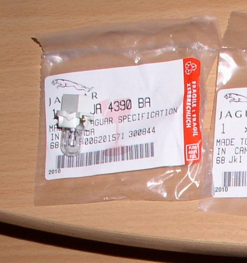

OE replacement from Jaguar is supplied complete with the bulb holder:

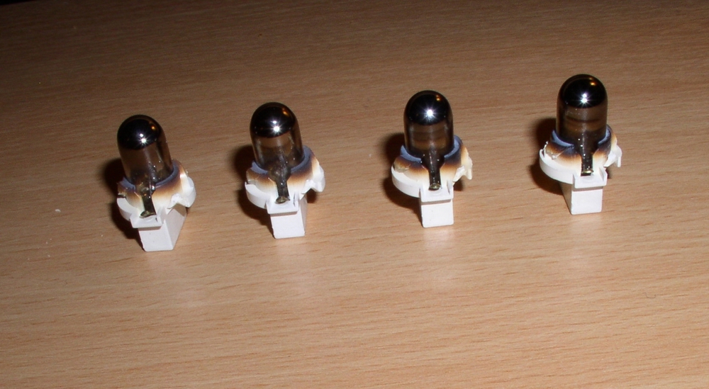

I thought this was extravagant and unnecessary until I saw the condition of the bulb holders in my 2005 XK8:

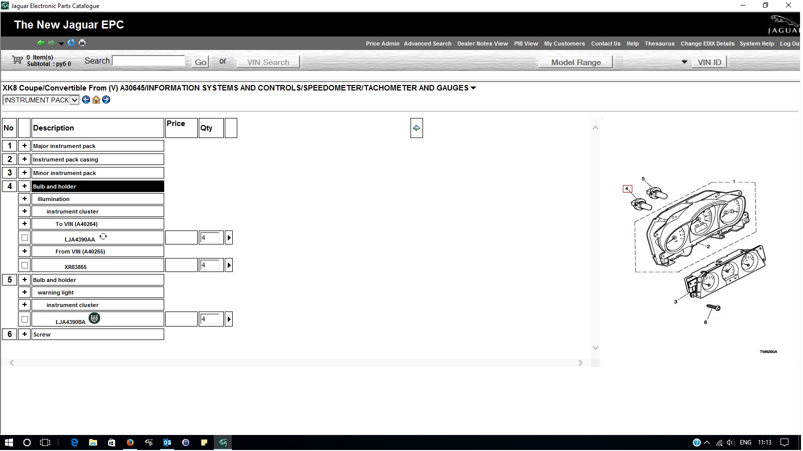

If you want to go OE, here's the extract from JEPC:
The main illumination for the IP is LJA4390AA or XR83865 depending on VIN. Given the work involved, it's a good plan to renew ALL the bulbs.
