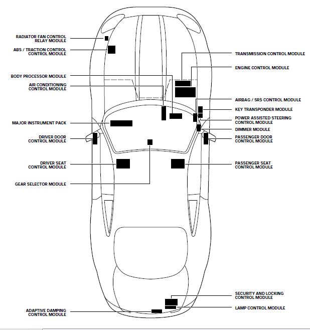

Although there is a very slight chance it is the instrument pack, I think it is much more likely to be the dimmer module. See location below in RH side of dash.

Steve, is that diagram for a RHD?
Actually it is LHD, but the dimmer module location is the same on the RH side of the dash in both models.

Turned out it was the instrument pack after all. I bought a refurbished one for £63 delivered next day and a dimmer module just in case (got it for £20 so worth a gamble)
Thank you all - I won't be so silly next time!
