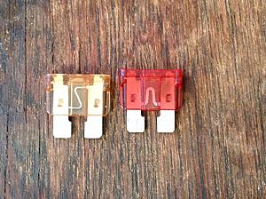

Other posts on here about replacing fuses that look fine fixing a dead radio led me to try replacing perfectly good looking fuses.
And it worked!
Check out how the bad ones looked.

I wonder if pulling what looks like a good fuse simply "re booted" the radio?
