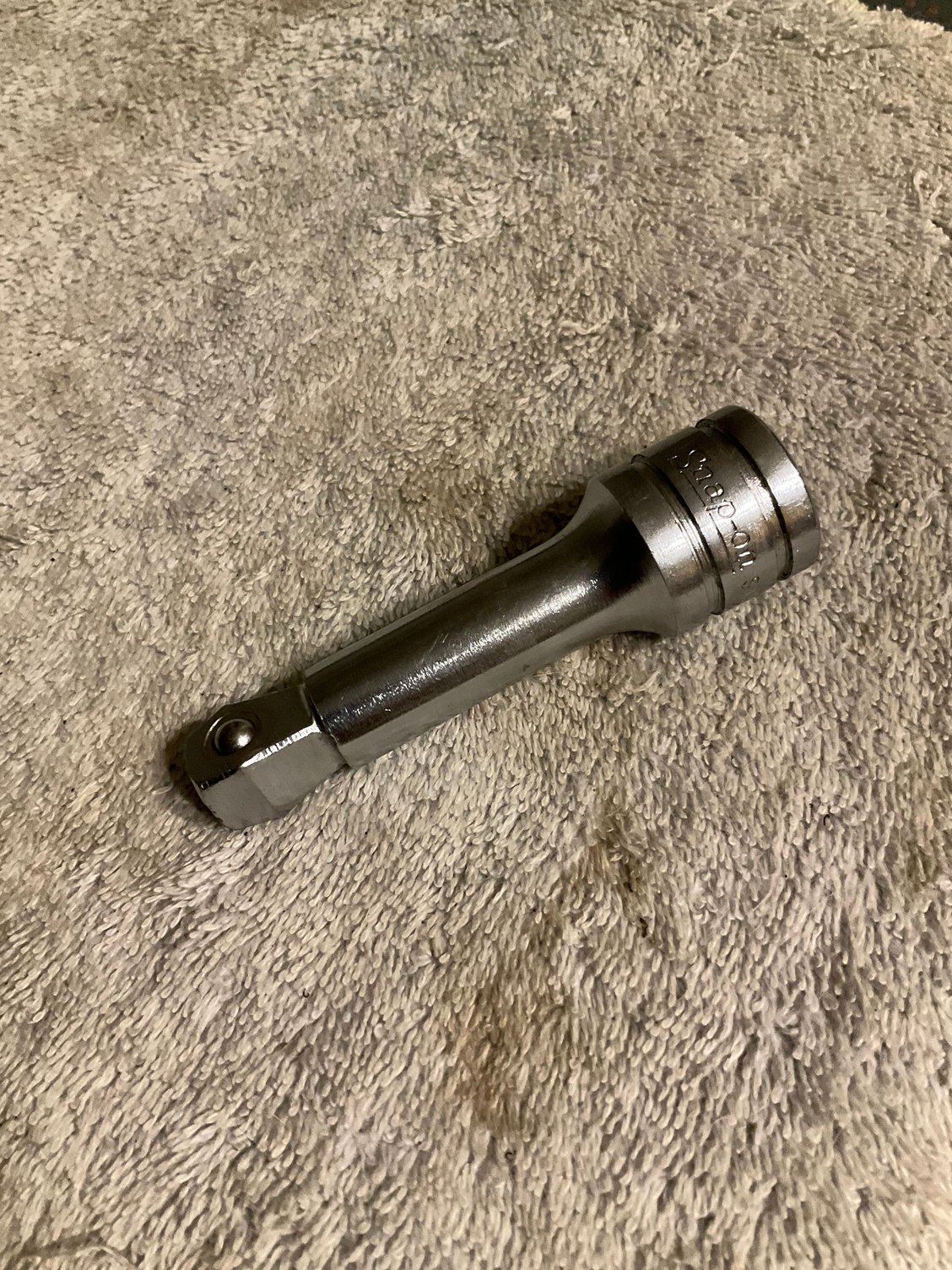

I have a 2001 XKR coupe and I changed the differential fluid late last year.
I used a Snap-On ‘SXW 3’ 1/2” drive wobble extension and it worked great.
Yes - the drain plug is tapered. You can actually install the plug by hand if you lay on your back parallel to the axels with your head towards the right rear wheel and reaching up with your right hand.
Someone mentioned that if your differential is leaking at the pinion side then probably the vent is clogged. I need to check that now…
Snap-On SXW 3
Snap-On SXW 3
