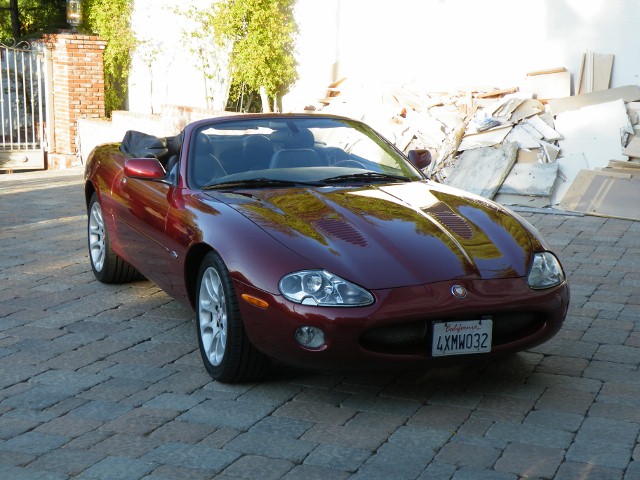

Well, I picked up my XKR, early this afternoon, drove it all day long, over 125 miles, and I am happy to report that everything seems normal. I will check and see if my mechanic held on to the broken tensioners so that I can take a picture and post.
The build date on my car was 07/01 and the vin number ends in 22424, and the tensioners were definitely made of plastic.
Apparently, my luck may have been attributable to two things. First, I shut the car down before it engaged and in less than a half second. Secondly, it appears the upper driver's side chain snapped immediately after the tensioner broke and somehow got bound up on the broken pieces of the tensioner somehow preventing the valves from hitting anything.
The cost of the complete tensioner/timing chain set from Christopher's European Autoparts was $689.00.
This set included upper and lower tensioners, chains, seals, gaskets, shortened bolts,...everything.
I paid approximately $800.00 in labor. (It is approximately because I had my mechanic change the water pump and he paid for the pump, I had him take out my broken radio antenna and replace it with both the antenna and the labor added). So I got away with about a $1600.00 repair when all was said and done.
Frankly, since this car was serviced at a Jaguar dealership for its whole life prior to me purchasing it at 60,000 miles, I just don't understand how these were not replaced during its many, many trips to the dealer.
I will not, however, take it for granted ever again.
My cat's back home tonight for the first time in almost 2 weeks, and I missed her dearly.
