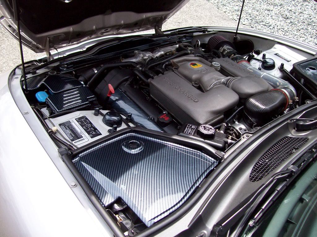

You should try & route your intake down so the filter is behind the headlamp, because right now you have a hot air intake that will be worse in the warmer weather.
I think the pic is distorting the way it really sits, here's a better one. It's as low as it can go...
I have the XKR type louvers installed in the hood, so I'm thinking that the extra air flow pulled from underneath and then exhausted out the top helps mitigate the engine compartment heat.

JgaXkr's Avatar
Posts: 1,700
Likes: 286
From: Boston Mass
I think you will find you are still drawing in hot air from the engine bay. I had a similar setup at one point on my XKR & you could feel the diffewrence on a hot day. It was like I had 1/2 the boost I was used to. If you are interested I have an aluminum intake pipe from Eurotoys that would look nice with your setup.

Default Where'd You Get The Graphite?
How was the graphite in the engine bay done (or where was it sourced). It looks great, was going to try a wrap myself but doubt it will handle the heat.
