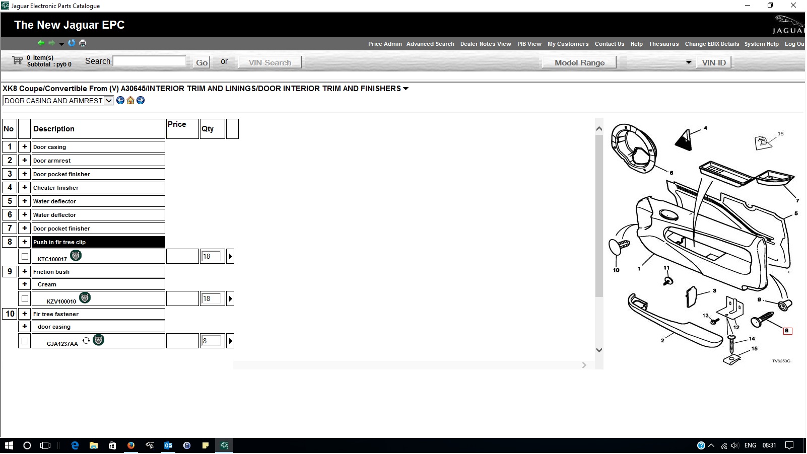

Old Oct 2, 2017 | 02:42 AM
Here's the relevant section from JEPC (Jaguar Electronic Parts Catalogue):
As suggested, Forum Sponsor S N G Barratt list stock:
(click on the images to enlarge)
At this unit cost, you could be pushing your luck asking for 10% discount!
