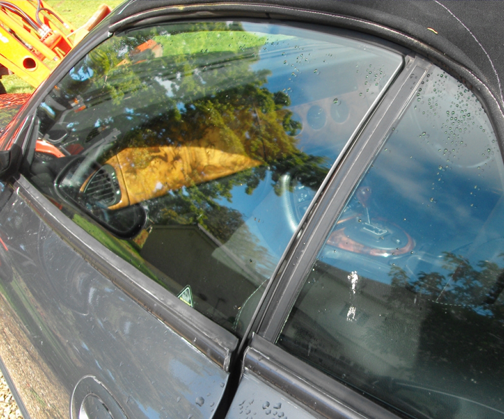

Today I noticed that both my door windows lean in like this so that the top of the glass is touching the seal well before the bottom.
I would appreciate if you could have a look at yours and report back if this is normal or not.
Thanks!

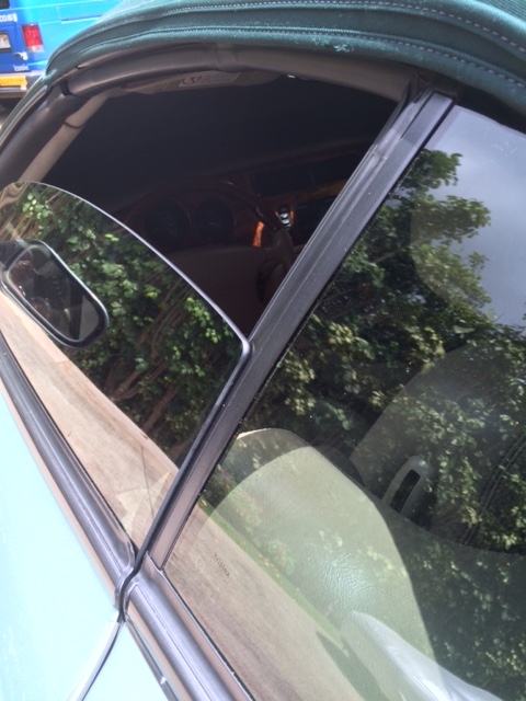

Hi RD.
Tried to take a photo at pretty much the same angle as yours - this is what mine looks like .......
except I just realised mine is front-to-back, and yours is back-to-front

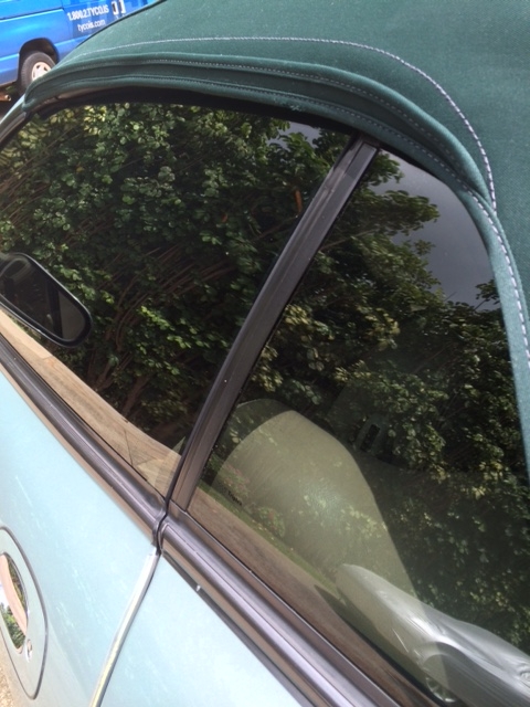

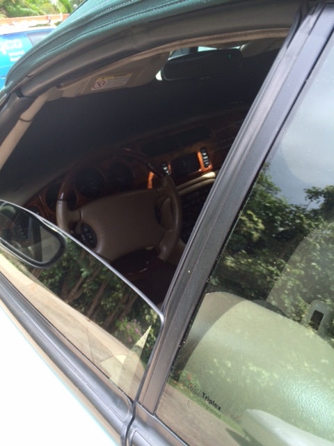

there should be no angle, here's mine
Attached Thumbnails Door window lean-all-up.jpg   Door window lean-three-quarters-up.jpg   Door window lean-one-half-up.jpg   Door window lean-one-quarter-up.jpg

From: Devon. U.K.
Mine seems to be like yours - just touching at the top but about 1cm at the bottom.
Whether or not that's normal - I don't know.

From: Goldsboro, NC
mine looks about the same as Davids...

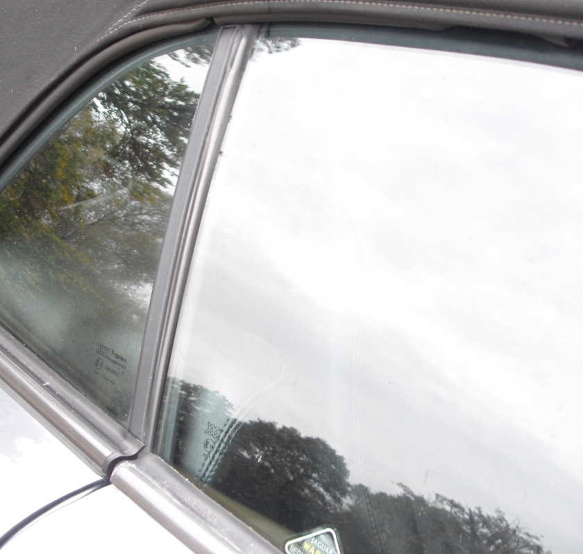

Default Door window lean
Racey-----
Mine, like yours leans--almost exactly like yours---see photo.
However, that doesn't mean it's right. I've always had a problem with the "auto" raise feature on the drivers side. It goes down perfect, but coming up in the "auto" raise, it will stop about half way or so, and go back down.
The passenger side glass leans in at the top also, but not quite as much and it works fine in the "auto" mode - up or down.

RD, David and mine are about the same and your's and Chucks are about the same. I "think" some angle is required for a good seal with the rear window, as you can see in my photo's of the window in different positions with the door closed it goes up and down with a tight seal.
If anything you might want to adjust yours a little with the bottom rear adjuster so it does not lean so much but as long as it seals with the door closed I would not worry about it.

Back to the Window Lean. As a person that can't rest until he tries something new, after thinking about the window lean on our cars, I had to find out , so I popped the red puddle light on the door, and as Seismicguy said above, there indeed was a hole to adjust the lean of the window.
I adjusted the window until there was hardly any lean at all. When you close the door until the first click--not all the way--- the bottom of the window now has about 1/8th of an inch opening at the bottom. The top just touches the upper rubber at the top.
Drove it yesterday on the highway for about ten miles--up to 70MPH---no wind noise. So in my mind, the window does not need to lean as much as that shown in our pictures----no where near as much. Depending on how alive the rubber seal is on the quarter window, a near vertical window would still seal out any wind noise....If the rubber on the quarter window is getting a little on the "long in the tooth" side, it may require a little more tilt (lean) in the door window. In fact, I would bet Jaguar adjust the door windows to where there is no wind noise and that there is no set lean as we may have thought.
