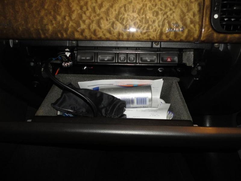

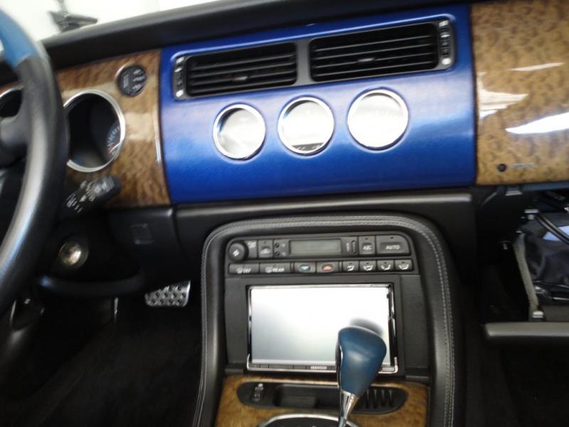

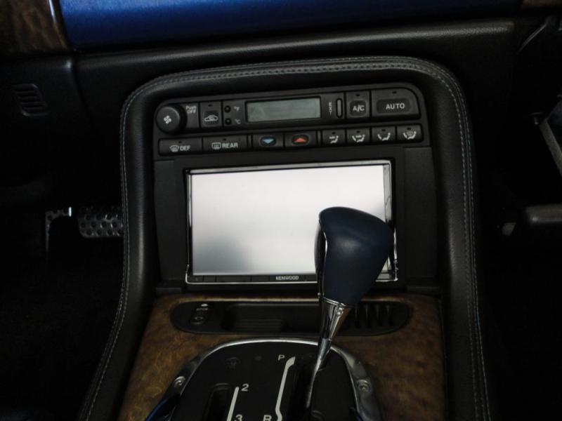

OK yesterday got the Double Din into the XKR, still sorting out the speakers, they wired the subs as full range so they aren't firing properly. Seat heater/hazard/fog switches were moved to the glove box and replaced the little shelf on top. Installation time, including custom dash piece, was 8 hours. Did the nav delete kit and it was vastly easier than I thought. The blue is brushed steel vinyl wrap. I'm getting better at applying it. So for all of those that said a Double Din wouldn't work. Hah!

It fits, great! I,d like to see a few more pictures as well as the glove box set up if you get a chance. Can you take the blue off if you get tired of it?

Yeah, I'm with the other guys...I commend you on the double-DIN install, it looks great. And I'd love to see how you set up the switches in the glovebox.
But that blue just comes out of nowhere and looks wrong. Just my opinion.
Old Jun 18, 2012 | 10:57 AM
The DD install looks a neat job. Any more detailed pics of the stages in fitting it?
No comment from me on the dashboard panel - you've already been beaten up sufficiently.

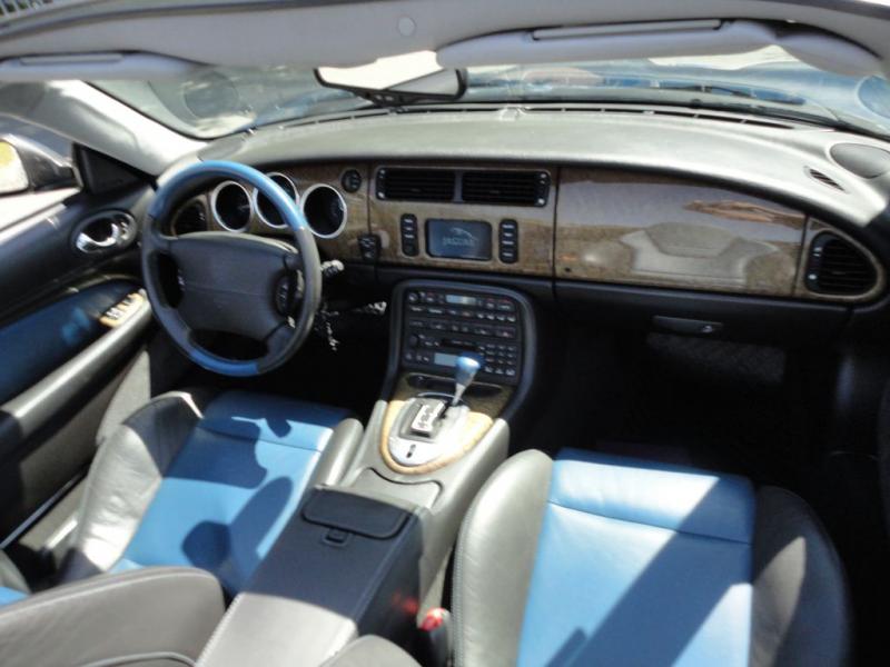

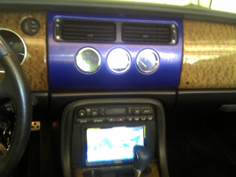

OK so remember this is the 2004 Portfolio edition, all done in blue inside and out (seats, wheel, shifter all blue). The Dash is a special wood as well so you can't match it when you pull the nav unit. The wrap is pretty easy to change (this is my 4th attempt and I'm getting better). But it actually, to me, ties into the hood and seats nicely.
Here are some better pictures. I included a shot of the old Dash. I still have the part in case I eventually want to go back (I won't go back).

That looks amazing! I love the double din. I also like the fact that you do what you like and not what the "norm" is. We all have a love affair with these cars and however you choose to customize is up to you....dont be swayed because it may not appeal to some others. I have to find me some recaros!

It's not impossible to match the replacement centre section to the original dash veneer if you want to. Check this site:
British Autowood > Dashboards
Their work looks to be very high quality. Of course, the cost may reflect this!

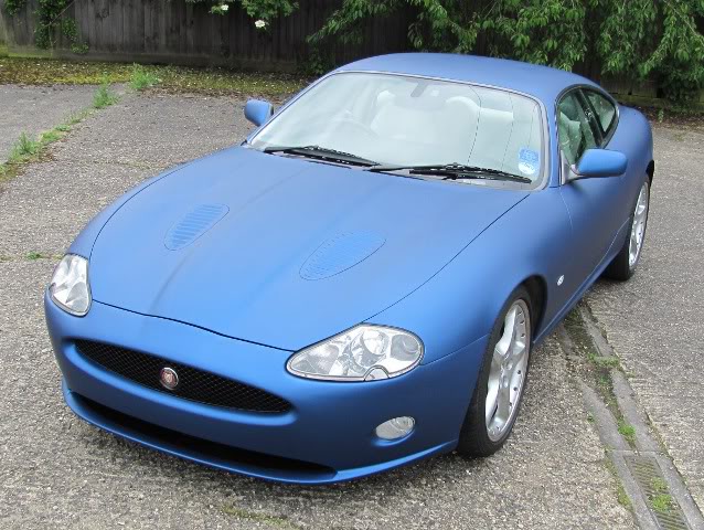

Why not carbon fibre to match your tonneau cover? I would even go as far as to wrap the lot, may not do the blue, but then again I just wrapped an entire car in a metalic matt blue wrap, which is not far off what you have done.

Originally Posted by enderle
Would love to see the picture of the car you had wrapped.
Not a problem
