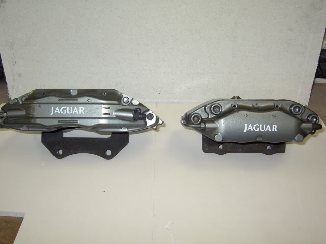

Just to throw another spanner in the works Graham , my 98 XK8 has Brembo's with cross drilled discs but mine has the early calipers which are painted a dark metallic grey as standard , the calipers differ from the later ones in as much as the caliper has a built in mounting bracket. This enables the calipers to bolt straight on to the vertical link without having to tap the thread out , as is necessary for the later Brembo's if retro fitting .
They take the same pads as both later types of caliper
No problem with any additional noise with the cross drilled discs incidentally
