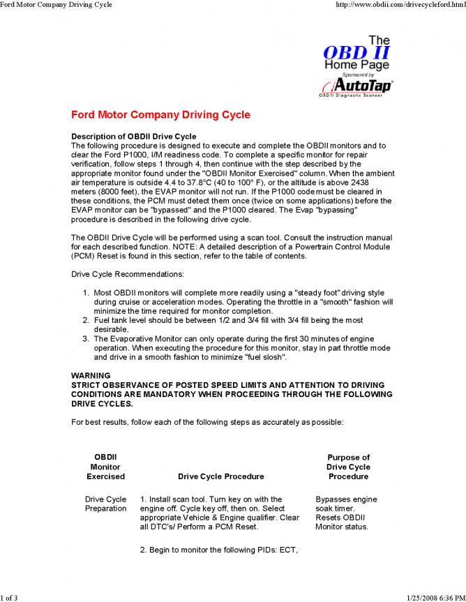

Here's one I have from Ford, don't know how good it is.
Attached Thumbnails Drive cycle-ford-motor-company-driving-cycle_1.jpg   Drive cycle-ford-motor-company-driving-cycle_2.jpg   Drive cycle-ford-motor-company-driving-cycle_3.jpg
