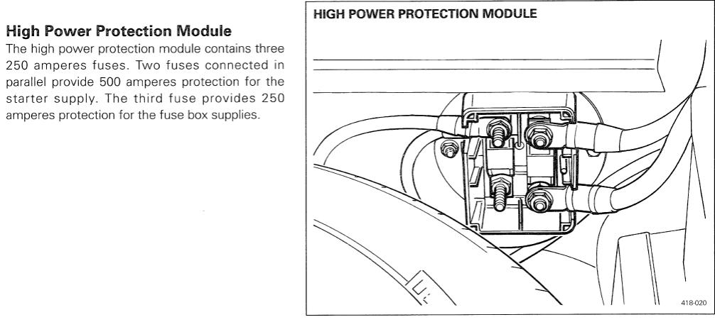

Not sure this is it but the high power protection fuses in the trunk that seem to crack or at times have a loose connection. You have 2 sets of fuses one double fuse for the starter and the single for the eng control units under the hood. But I am concerned that you were unable to start (crank) the car leading me to think it is the power supply. I would look at the entire power supply. I have car onelines on my page http://www.gusglikas.com/AutoRepairElectrical.htm that may help. Be sure to disconnect the battery first.
Attached Thumbnails Electrical Gremlin cuts off car-highpowerprotectionmodule.jpg

We found three cars that had a problem with the fuses. It seems that the tire in the trunk when not secured or when it is moved will bump the fuse box resulting in the box and or fuse to come loose or defective. When you check the leads on the battery the movement may be just enough to make contact to get you home. The one most important thing I can say is to remove the battery terminal prior to messing around with the wire connections. A DC flash is a nasty thing!

All depends if it is broken (cracked) or loose.
