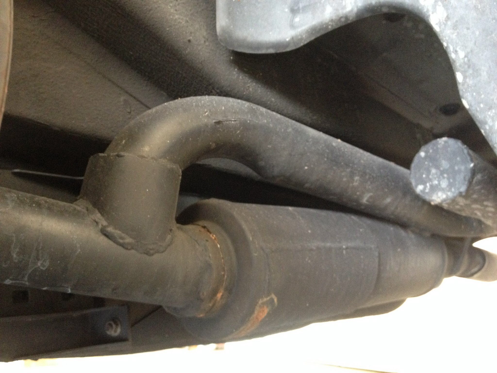

Here is a photo of one side of the exhaust J -pipe.
Old Apr 14, 2015 | 06:21 PM
Majik Lasers's Avatar
Posts: 177
Likes: 8
From: Chicago
That is interesting...and yes, similar to the intake silencers. You should post a video of the sound!
