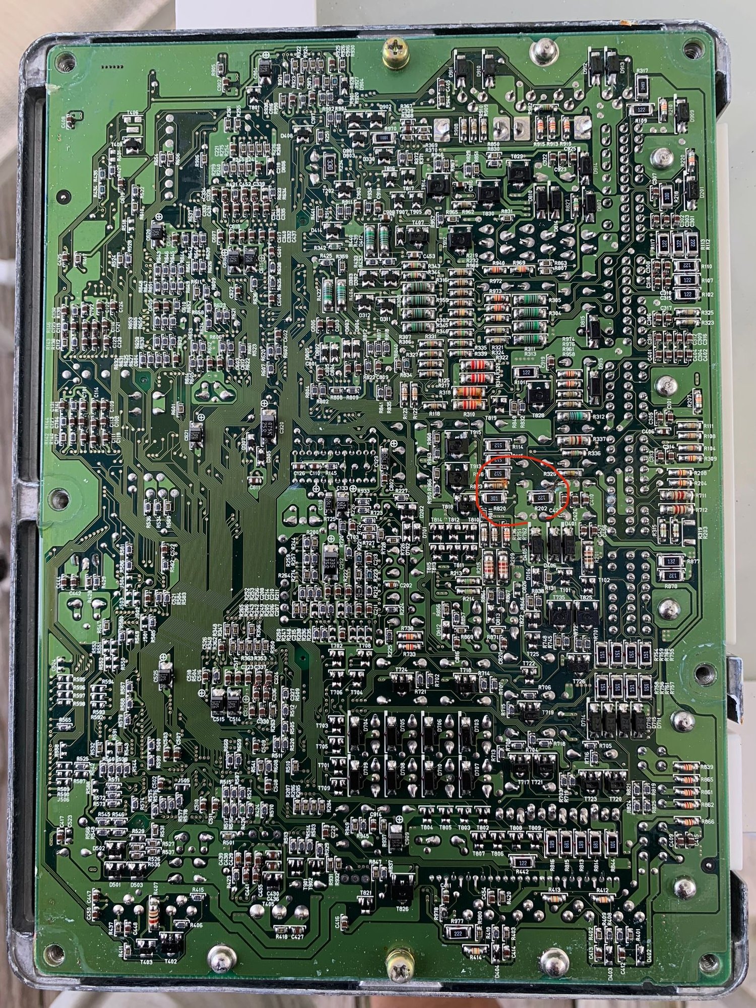

I pulled and opened the ECM. I have at least one orange colored capacitor which has apparently failed and spilled fluid. I plan to send the unit to a diagnostic facililty. I am open to suggestions. I see ecudoctors.com in Florida as a possible provider. Any suggestions???

There's also Module Repair Pro in Van Nuys, CA or, possibly, ASI. Best to call to check if they can oblige, I guess.
Can you post a pic of this please?

Originally Posted by michaelh;[url=tel:2653858
2653858]There's also Module Repair Pro in Van Nuys, CA or, possibly, ASI. Best to call to check if they can oblige, I guess.
See capacitor where marked with circle
not sure the photo is dense enough to show it

Thanks for the pic. There is some detritus between R823 and the resistor R?6 marked '512' above it
but that should clean off with a little isopropyl or distilled water on a Q-tip.
No electrolytic caps there that I can see, but there will be more components on the other side of the pcb.
Beware that the repairers can be tetchy about taking in modules that have been opened. Isn't Autoecu.com ASI?
