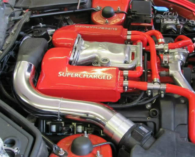

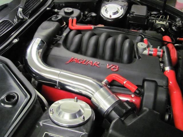

Same pipe does XK8s, Rs, and will do XJs as well although I have not fitted one to an XJ before but can not see no reason why not......
The slightly dented one is going for £100 which is less than half price plus shipping
Looks just like this one
Found another pic with an XKR
