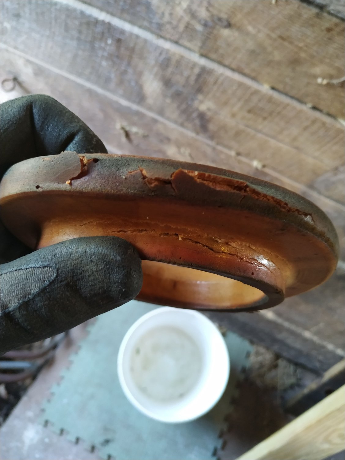

When I took my 97 xk8 in for inspection, my right tire was worn on the inside. I measured the distance from the center of the wheel to the wheel arch peak and I was 14.5 on the right and 13.75 on the left. I bought a strut tool, and I ordered two front upper strut mounts from Welsh and they showed up today! Not a horrible job really, with the right tools. The mounts were both shot, but the left one surprised me! The hole the strut rod goes through had shifted to one side! I guess that would make the difference between the two sides! Ride height is bow back where it should be and everything seems good!

Glad to see that things are getting better.
That strut tool surely made the job easier. Wish I had one but I am too cheap to pay for it.
Remember to get the alignment checked. If you can find it, buy a lifetime alignments deal. It is worth the extra expense.

Were the new strut mounts made of poly? My wife's 2003 with 74k miles are worn ... at least they measure only 14.5".

I'm not familiar w Jaguar suspensions.
The ride height on my 2003 is 14.5" and excessive negative camber. Alignment was recently checked and only change was some toe adjustment.
So is it most likely worn strut mounts? I can't think anything else would cause this with only gently driven 74k miles.

Yep. If you are still running on your factory upper shock mounts, that is indeed your issue. Check out the Welsh Enterprises poly upper shock mounts that many of us have installed and are quite happy with....
