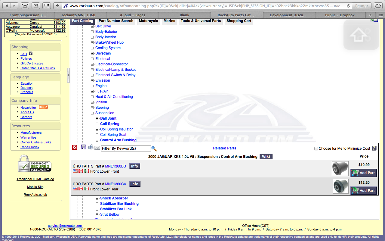

So, are both parts that appear on screen the same? If so, I'd order two of the $10 part, right?

The lower control "arm" is actually two pieces. The reason the rockauto catalog is showing two numbers is that there is a front and rear bushing. See bottom line to the left of each listing.
On the X308, the factory eventually substituted the rear bushing for the front position as well since it is firmer. There was a TSB for this. The Xk8 may be the same.
So wait, I have to buy four of these bushings? Two for each side?
