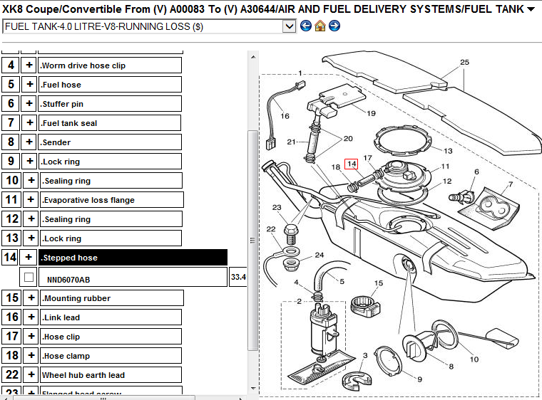

Bit after-the-fact now, but I looked in JEPC & Heritage last night, and couldn't determine which was the correct part so didn't want to give you duff information.
It is either a 'breather hose' NNA6068KA13, which is about $7, or a 'stepped hose' NND6070AB which is about $70.
I believe it is the latter, so your $30 fix might not be as expensive as you thought.
