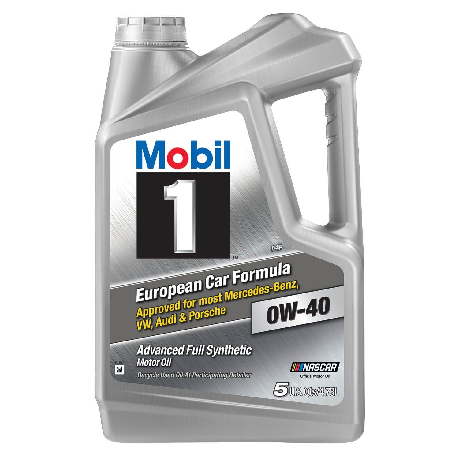

Do the European spec oils say that on the label? Does it say "European spec"?
Which oils are ES?
Are they readily available?
Old Jun 5, 2021 | 09:08 AM
  #32
zray's Avatar
Joined: Jan 2018
Posts: 3,748
Likes: 2,338
Which oils are ES?
Wal-Mart has it:
this is generally what the 5 qt jug looks like,
although they are continually changing the packaging, but not the formula, as far as I can tell.
Z
PS. I don’t know if it’s available in other viscosities, this is the weight that I buy

these oils as as easy to find as water, and just as inexpensive. They are clearly labeled. Mobil 1 European Formula and Castrol Edge European Formula which i use a lot are very inexpensive and easy to find. The 0w-40 is the most common variety. If you want to use a 5w-30, Castrol 03037 Edge 5w-30 A3/B4. It must be a Black bottle. Note that the Amsoil Product in the 0 and 5w -30 European Formulas are medium to low SAPS (just like the wear preventers like ZDDP) described above, and for their much higher cost it makes no sense to give up this insurance. Did a little research and if one wants an Amsoil product with the wear preventers at high levels in a 5w-30 for any car with a simple normal catalyst system (no diesel DPF) go with their series 3000 heavy duty diesel oil 5w-30. We use this in 90s and early 2000s Hondas that call for 5w-30 and it noticeably protects their cams with no emissions equipment issues. Remember that it exceeds the API required for these cars while not reducing things which are needed in terms of solids as wear preventers. And it is very cost effective, downright cheap for a very good oil.
Note that 0w-40 in general is essentially the old 5w-30 with better startup flow in terms of performance and wear protection by oil film strength. Thus, it is never too "thick" for even a very new 5w-30 car as all of these cars in Europe would be run on 0w-40. One is not putting something the equivalent of glue into the case as opposed to 5w-30. In fact, when some friends are going to push their even stock Hondas they go to 0w-40 for a little extra high oil temp protection. Remember the very important point that i am making in this thread is that certain, definitely not all of course, improvements in oil harm certain and perhaps all cars by removing wear preventers for the very few vehicles where they will poison specific emissions control equipment. It is the problem with the sixties cars and less ZDDP all over again. It is very cheap to get oils that have these things. And one does not make up for it and perhaps does harm by going crazy thick with oil under most conditions and by dumping thickening products into the case fill for this purpose.
