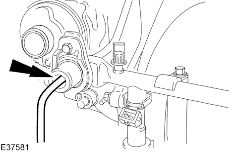

[QUOTE=giandanielxk8;1168966]Are you talking about the one that is covered by a heat shield sheath? I'll take a look at this, I remember having had to mend it once.
No, that is your brake booster vacuum line.
I am talking about this one
Attached Thumbnails Gas Leak at Passenger Fuel Rail-fuel-press-reg-vac-hose.png
Well, yeah, I had to disconnect it and reconnect it, but it is in good shape. I'm pretty sure of that. Was I supposed to remove the regulator without disconnecting that line from it?
I'm starting to think the regulator did not at all like being dropped.
