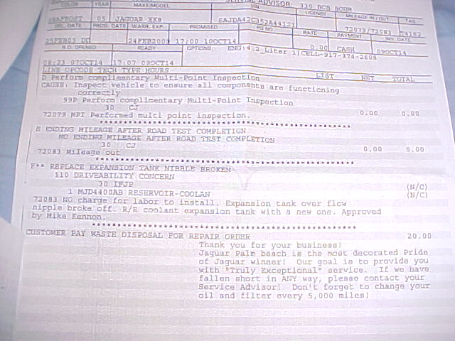

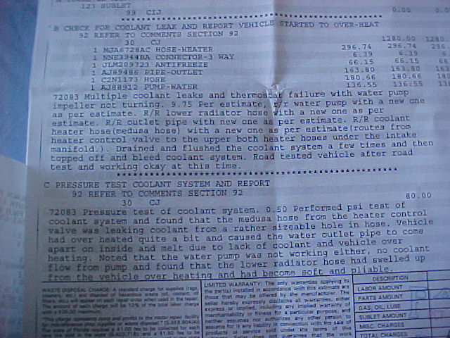

Based on the work order it looks as if the overheating had been going on for quite a while and eventually went critical to cause all that damage to that many hoses, etc. An oddity is that the plastic nipple on the expansion tank broke as did the one on my wife's XJ8. In my case that created a pressure leak as soon as the car got hot and I was able to track it down after about three days of radiator top offs followed within the same day with another low water level warning.
Your problem may have started there or with w failure of the water pump but in any case someone in the ownership chain ignored the warnings and or the maintenance.
