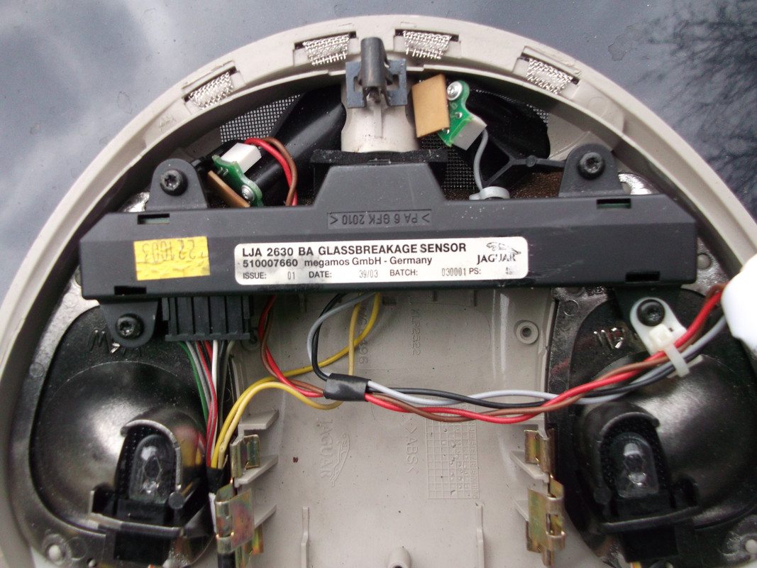

It's a PITA. Mine had to sleep out for a period, and would do the same:- usually in the wee small hours
I suspect the glass breakage sensor in the roof console is the culprit, however disabling part of the security system may compromise your insurance?

Yeah, it's the glass breakage sensor which uses soundwaves.
Sometimes heavy rain or hailstones on the windscreen can match the frequency of glass breaking and trigger the alarm.
Easy way is to stick some foam tape over the mic and muffle the soundwave.
Early xk8's have the mic between the interior lights, so no need to drop the roof console.
