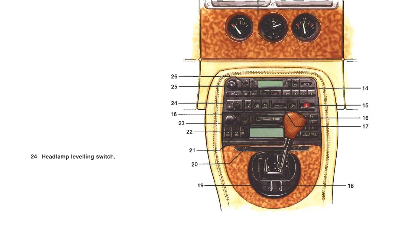

It's always dangerous to make assumptions about different market specs but I didn't think Auto Leveling was available in '97 MY - unless this was different for Australia?
Do you not not have a 4-position headlamp leveling rotary switch (see item 24):
On UK spec vehicles, this controls the headlamp leveling motors.

Thank you Graham, your replies are most appreciated.
You are correct, my car does not have the manual rotary switch on the console. I therefore assumed it must be automatic. Yes, I know the dangers of 'assuming'
Ie they make an *** out of U and ME.
Interestingly my X 300 has the levelling servos behind the lights but they don't do anything, bit hard to understand. If they are not auto levelled it begs the question of why they seem so low on high beam.

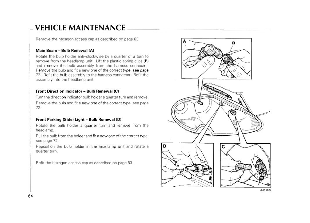

Four bulbs in the Headlamp Unit:
Three changed through the very awkward plastic cover:
1. Main Beam
2. Front Direction Indicator
3. Front Parking

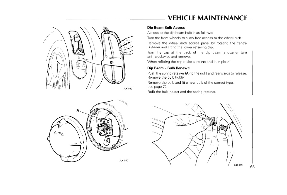

4. Dip beam - changed through the wheel arch access panel:
Condensation is a regular issue but water in the headlamp Unit suggests a faulty seal between the lens section and the plastic housing.
