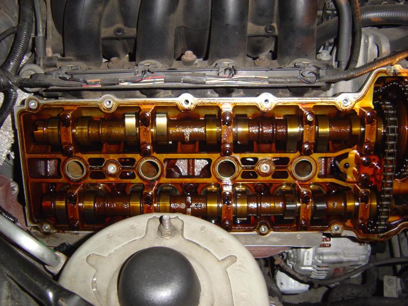

Well I started in on it today and here are some things I found on the passenger side. Didn't quite have enough time to do both today but I did end up replacing the plugs. Bought some Bosch Platinum + and use the recommended gap of .040". They didn't have the NGK's in stock and I wanted to get them chaged.
Results:

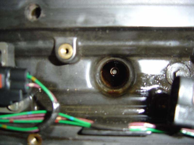

hint of oil in 1st well.
Butt-load in the 2nd well, I could barely see the top of the plug and the boot was wet for the first inch.
3rd & 4th were dry

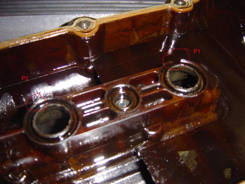

A chip out of the valve cover around the 1st well, and some slight cracks around #2 & #3, pic attached.

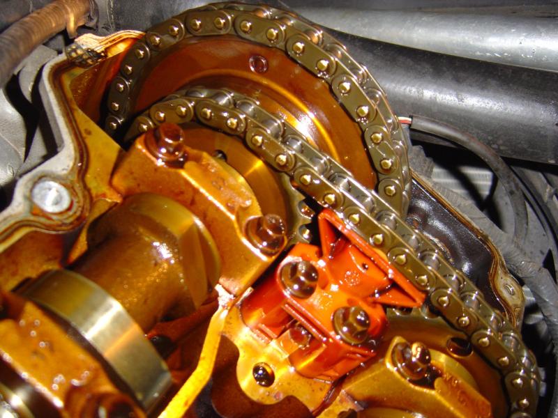

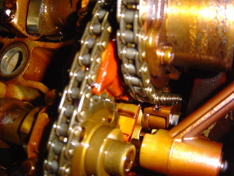

Also including pics of the tensioner so maybe some-one could let me know if they're the latest. Looked like a orange plastic body to me with a steel spring but I didn't notice any wear.
Results:
3rd & 4th were dry

Test Point is right...you CANNOT see the damage on your tensioners until you take them off. I know (and many others know as well) from first-hand experience.
You've got to get them replaced...now...and with the cam covers already off, your job is nearly half done already.
+1 on changing tensioners, I just replaced mine and echo what's said above, you're half-way there already. Yours are the first generation and they've put in some good service on your car, but you'll be ahead of the game if you replace them right away.
On the oil in the plug wells, your picture of the cam cover doesn't appear to show the o-rings - did you remove them when pulling off the cover? The cracks and chip in the cover wouldn't matter near as much as not having any o-rings installed.

Didn't mean to mislead on the covers. If you did have the o-rings installed, and you got so much oil in the wells, then you need to take a closer look at the reason. And that reason may be the cracks. Still, I'd guess you had enough surface bearing on the o-rings to make a seal if the cover was properly applied.
If you're ordering parts, you might consider a new cover too.

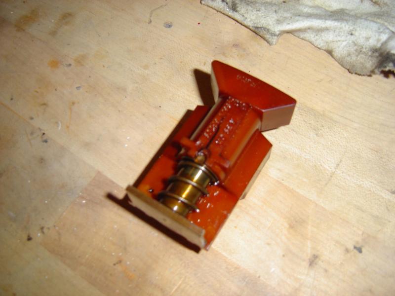

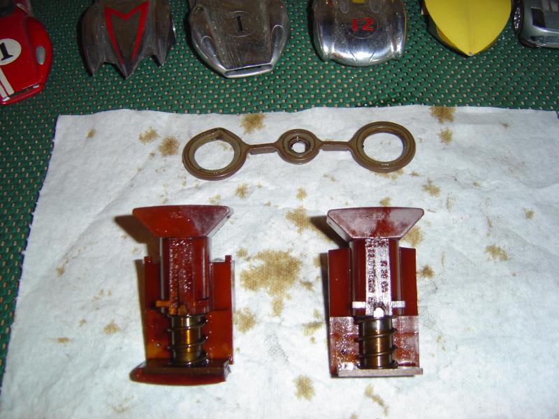

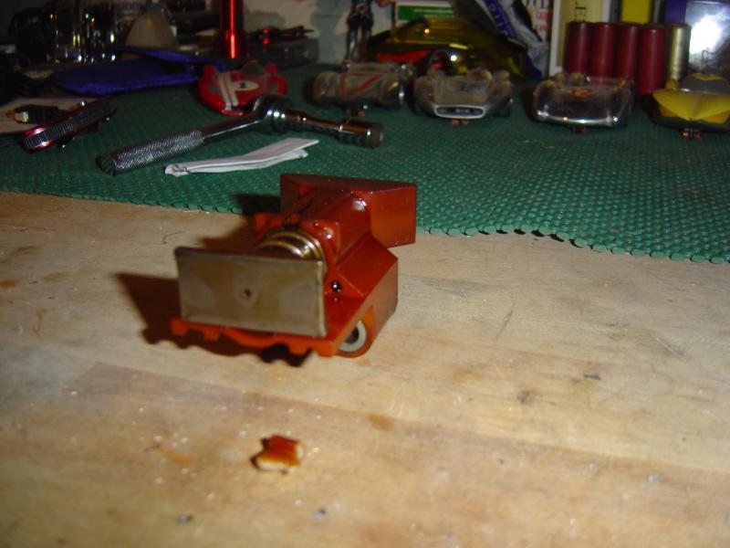

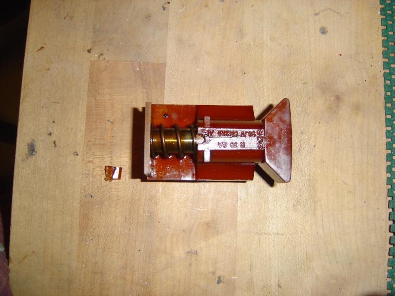

Got the tensioners in and finished the passenger side today. Forgot the camera but took some pics of the old tensioner when I got home. Really Really glad I listened to you guys and didn't get lazy about changing them out
You'll see what I mean by the pics. Yep, you really can't tell how screwed up they are till you get them out.
The one side of the tensioner is completely missing the plastic but I guess it couldn't extend far enough damage the chain thankfully. I inspected the chain after I saw it and didn't see any wear. I did find a small piece of plastic wedged between the timing cover but didn't find any more than that. Must of got chewed up or fell to the bottom of the timing cover.
Guess I'm one of the luckly ones so far
. Knock on wood dash, cross fingers, etc.
I'll tear apart the drivers side tomorrow and let you know how that goes.

Most of the missing plastic is in your oil sump, probably in the screen of the oil pickup pipe.
Ask me how I know!
I bought a new oil pan gasket, removed the pan and oil pickup pipe, and was amazed by how much plastic was in there, blocking oil flow.
My reccomendation is that you do the same.
Have a look at this thread for photos of what I'm talking about (pics are in the original post): A bomb, defused.

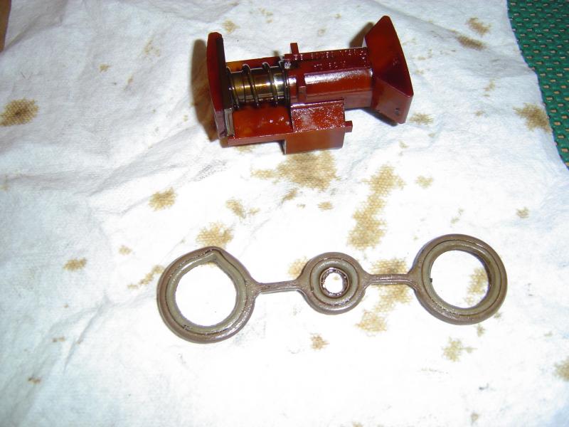

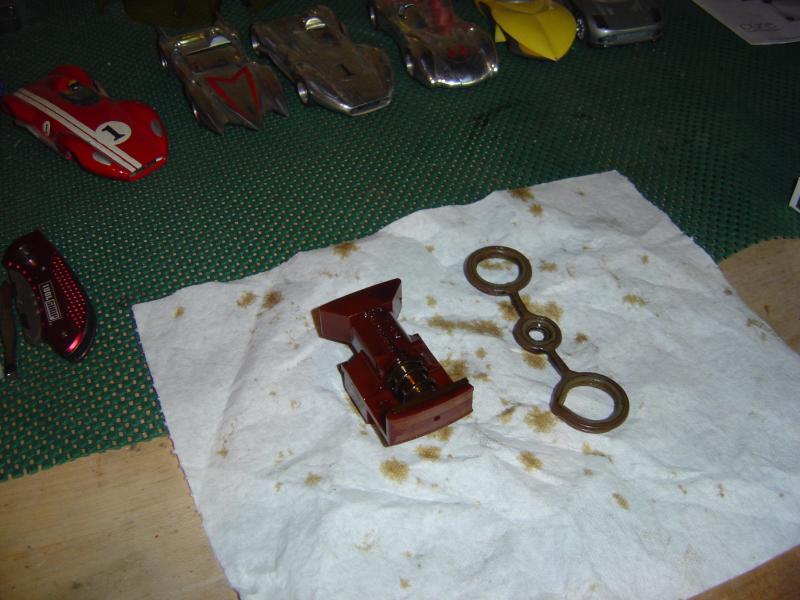

All done with the tensioners, and there was much rejoicing, yeah. Included a couple of picts for those interested. Diver side was in better shape but still had a crack starting in the body. Also the o-ring on plug 3 was a little messed up.
I was able to do the drivers side without rotating the dipstick tube. Firgured I give it a shot since I couldn't even see the bolt to loosen the tube and didn't need to.
I did Use the zip-tie method and it worked great.
Also I re-worked the 40mm lg screws that were in the car as I couldn't find the 35mm lg locally. Worked fine, just ground them down to 35mm and put through new tensioners to confirm there was enough thread. So if you have to change them and your in a pinch, now you know.
Only thing left is to find the rest of the plastic from pass-side tensioner. Waiting for the gasket which should arrive Monday.
I guess now it's time to add my name to the tensioner upgrade list and call this done.
