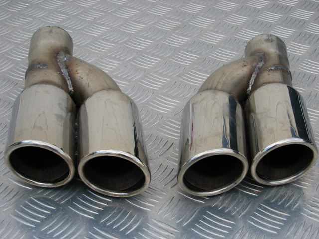

I also found a pic of these
I made these for my first XKR about 4 years ago, 3" quads, they did look good but really expensive each tip was $90 before I even picked up a welding torch, but nobody else had quad tips that big at that time
I had to baffle them to get even exhaust smoke...... Very cool
Man, you are amazing!!! The nice part about the way you made those is that they clear the floor of the trunk (boot?). The current 3" quads from Magnaflow, etc. look like they would interfere.
Thanks for the compliment...... And that is exactly why I made them like I did to miss the trunk floor, because I took a 'branch' off the main section is why I had to baffle it slightly. I get people supplying me large quad tips in the typical 'Y' layout and they simply will not fit. It is because they are so cheap appeals to people, I do get that, I have a set here, they are huge and there is no way they will fit straight onto the exhaust and clear the bumper without some serious reshaping, I am not saying impossible but it will look wrong.

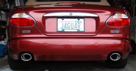

OK, guys. Here's the solution I know you've all been waiting for:

[IMG]file:///C:/Users/Steve/AppData/Local/Temp/moz-screenshot.png[/IMG][IMG]file:///C:/Users/Steve/AppData/Local/Temp/moz-screenshot-1.png[/IMG]The tips on the Maroon "J4GJ4R" plate convert look great. Can someone identify them please. They look bigger than stock, so I assume they are aftermarket. What brand and your source PLEASE!

Those tips look like Rezistanz, they are the same used by Adamesh for there back box replacement pipes, click HERE, I have a set in stock if you want me to take a pic
