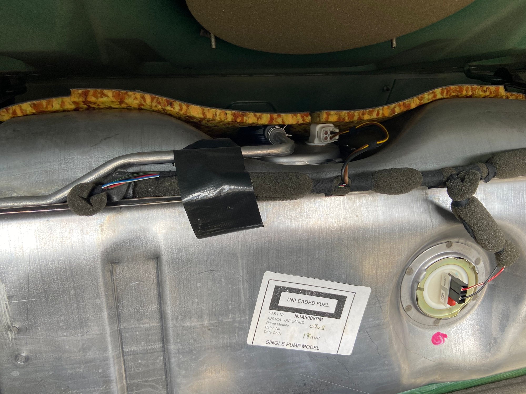

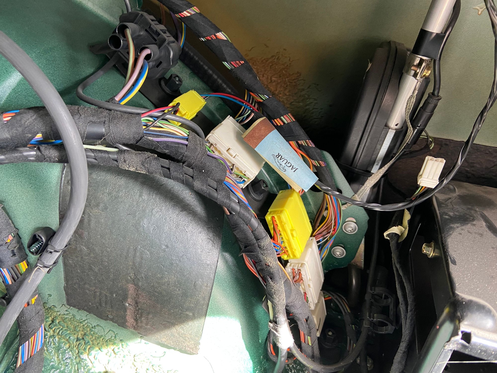

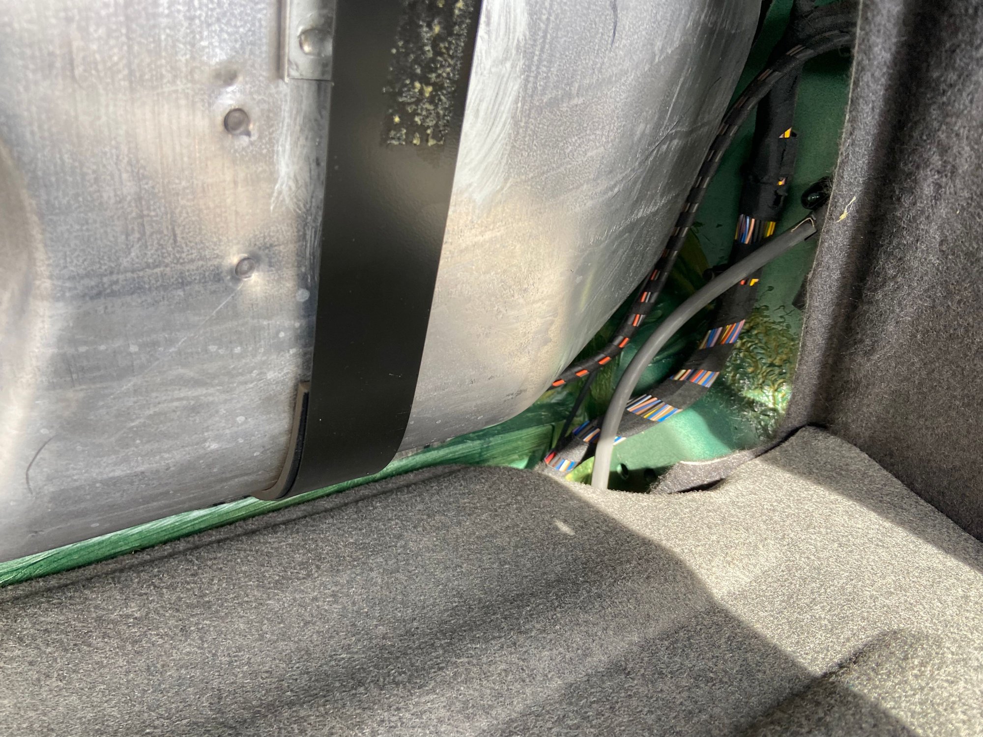

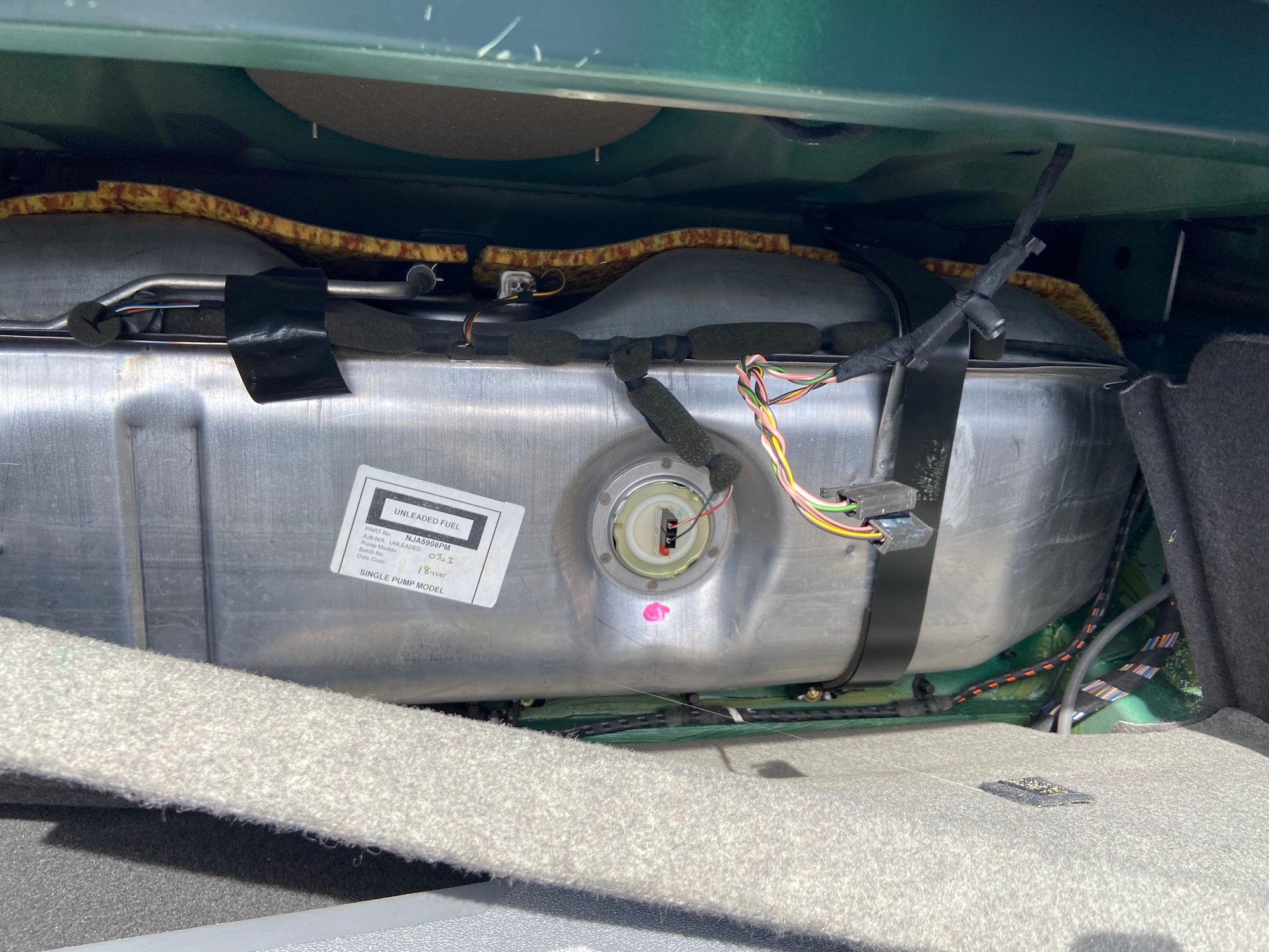

Hello all
I just but a 1997 XK8 coupé with 50000 km (31000 miles) in excelent condition
However, I just noticed that the connectors for the HMSL are hanging in the boot. I ve searched everywhere for the cables to connect them to and can’t find them.
Allready searched internet and youtube with no success
Can anyone help me please?

Hi tiago,
Do you mean these?

Hi Michael
Yes! Where do I plug those in?

Don't worry: they are connectors for the subwoofer that is fitted under the rear shelf above the fuel tank on cars with the premium sound system. They are not used in the standard configuration, so you can just tape them up out of the way.
