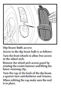

There appears to be some sort of access panel/cover missing from the right side ( NA passenger side ) fender liner of my car just behind the headlamp. At first I thought it was damage but a closer inspection shows that the hole has reinforced edges and (what looks like ) holes for fasteners for a cover. Does anybody have any insight of if there is an inspection panel in the fender liner behind the headlamp ? The driver's ( LHS ) seems to have one but it looks a lot smaller.

One of these?:
They should be the same size on both sides, but they are handed.
Part # is HJA4582AD for the RHS, HJA4583AD for the left.
HTH,
Mike

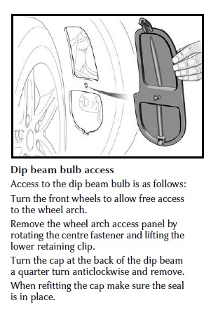

It's called a Wheel Arch Access Panel:
Hole in inner fender/wheel liner-access.jpg
Helps keep water from being sprayed directly onto the back of the lamp units.
