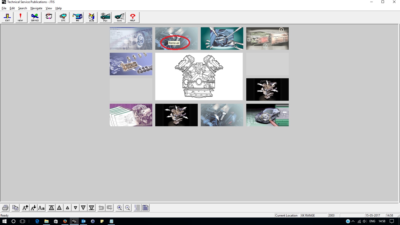

I know where to find engine removal in JTIS but despite searching your post and your forum user profile, I cannot find a Model or Year .........
Engine removal is only covered in JTIS for 2003MY onwards.
Look in Powertrain - Engine - Removal.
